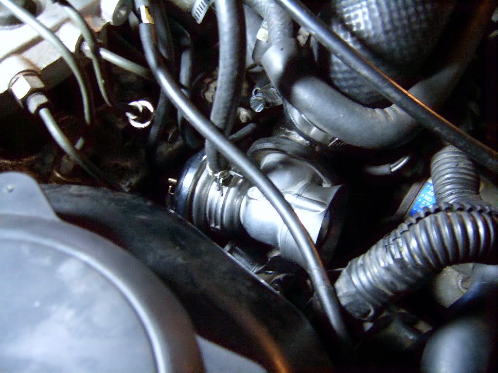

Okay, well, I went out and checked everything over, and guess what I found. Well, the clamps weren't even tightened. My friend put the stock bov back in, and both clamps around the charge pipe were loose and easily movable. Well, I took the stock bov out and have the hks one in again. I need to get new vacuum hose cause I think I was getting a leak from the one off of the UIM. Now, If you look at the gold connector in the 2nd pic I have posted, Should I just cap off the 2nd nipple, or does it go somewhere? Also, what should I do with the hole where the BAC was on the TID? Tomorrow I will finish everything, the car is in my garage now.

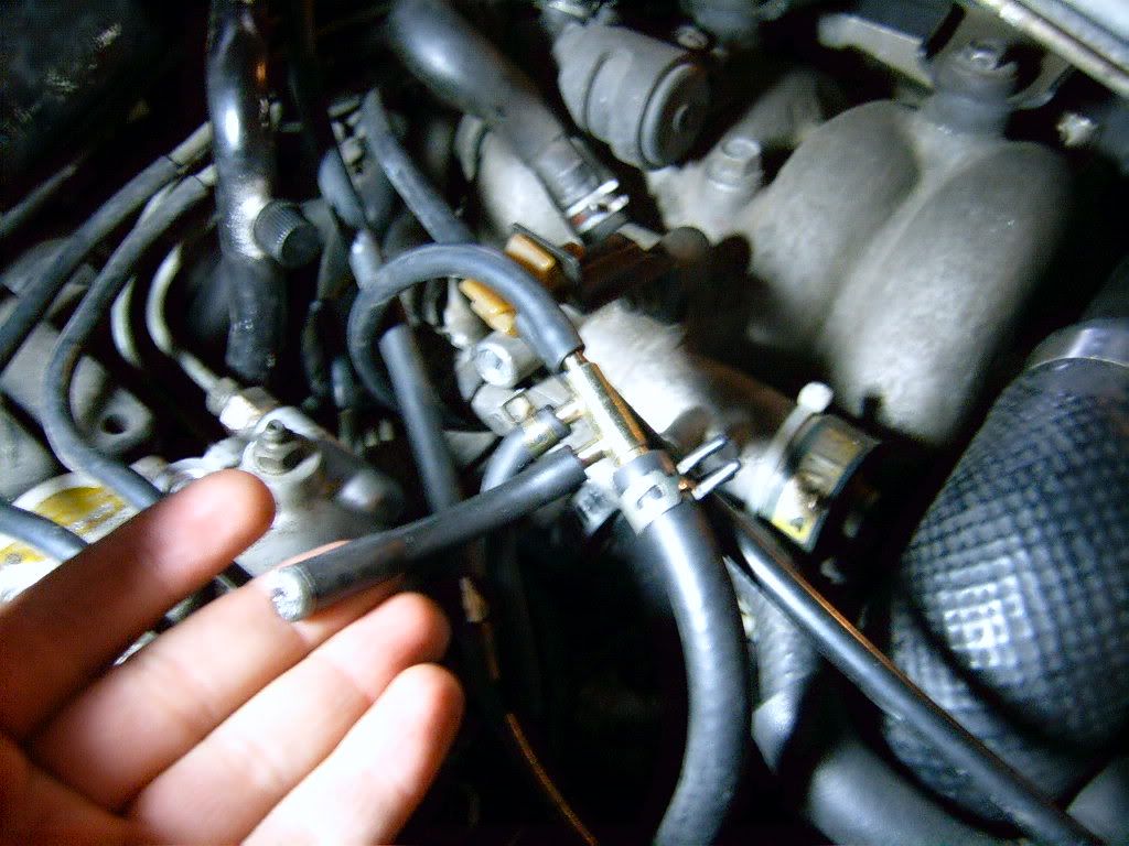

Okay, more pictures. Picture one is the bov installed. Now the bov has 2 hoses on it and they go into a fitting. The fitting is picture 2. I capped off the extra nipple cause it wasn't used (I don't even know if I would need to use it). Picture 3 shows the nipple on the UIM where the fitting is attached to. Now, should their only be one line coming off of the bov? I saw a thread on teamfc3s and the guy said the line coming off of the side is the return line. Should the line on the back/bell part be attached somewhere else?

I just brightened your first pic up a bit in Pshop, is the line shown the only one that comes off the BOV? if it is I don't see the point in having all of the rest of that plumbing?
to test to see if you left something off (pain in the @$$) replace all the original plumbing to the original BOV and see how it runs...

There is a line that comes off the back, and it went into a t-fitting. I removed the one on the back and only have the line on the side going to the UIM. We had the stock bov in and it was still idling like that. Also, I just upload all my pictures to photobucket and just copy and paste the links.
