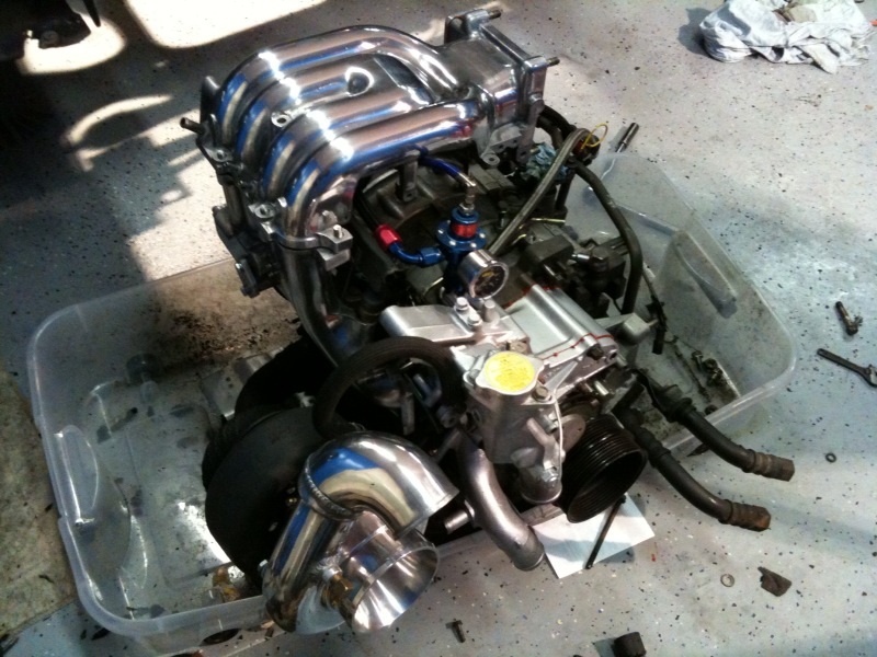

Just the beginning. I have everything on there for fitting checks.
Attached Thumbnails prepping the car for my GT35r setup :-D-turboinstalled.jpg
Old Jan 16, 2010 | 11:51 PM
BigTurbo74's Avatar
Posts: 431
From: Twin Cities, MN
Is that a rubber coolant hose sitting on your 1600 degree turbine housing?
Old Jan 17, 2010 | 12:04 AM
dhahlen's Avatar
FD Under Construction =P
Joined: Jun 2003
Posts: 4,022
Likes: 24
From: Avondale, AZ
what he said
Old Jan 17, 2010 | 01:36 AM
rdahm's Avatar
TurboRX7.com
Posts: 690
Likes: 85
From: Monroe MI
Great question. Its the coolant line but yes. I'm ordering the right parts from aspec. Thanks for the point out. And yes it's rubber.
