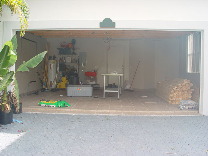

Wow, it's rare that I'm impressed by much on this forum, but you really did a first class job on refurbishing those wheels. I started chuckling when I saw the first picture of your junkyard "find", and stopped when I got to the second post. Nice job.
Sort of like the thread on AVS Forum where the guy starts off talking about building his own home theater in his garage...
And ends up with this.
