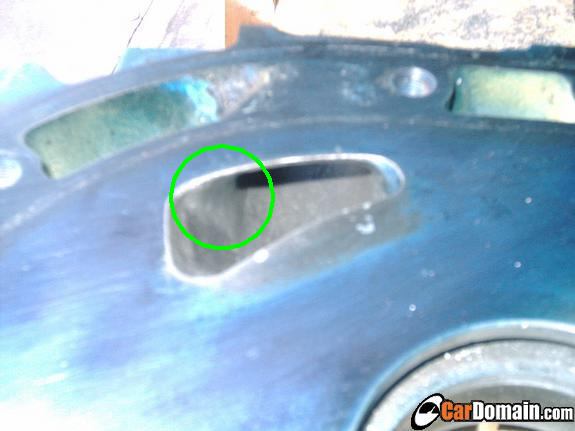

Hi guys, Im porting my first engine. Using RB streetport templates. Its in the final roughing out stage. Any opinions would be appreciated. Thanks!

Nah, not gonna go monster on this one. Maybe the next one. Thanks for the compliment. Does the angle at the top of the port down into the runner look good? Is it too shallow? I dont wanna make that pocket too big.

That looks better than most people's attempts on here. That should be fine. At least you can cut straight!

Carl, you might want to raise the roof here at the center of the circle.

Thanks Jeff. I was unsure about that area so I didint mess with it yet. I need to look at some pics now that Im knee deep in this. I'm guessing I should raise it a bit so the air can get a straighter shot into that part of the port, rather than making that sharp turn?
Carl stick your pinky in the water jacket and feel the backside of the port, it will give you a idea of how much meat is actually on there.

Thanks ZeroR. I recall someone telling me that a while back too. So Im gonna just blend that radius a bit more and call it finished.

I agree with Jeff to raise the roof a bit.The current radius it has will hurt the flow.
