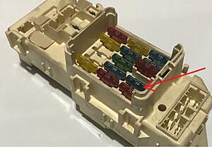

Does this 15 AMP Fuse Control the Radio and Cigar?

Old Sep 7, 2017 | 09:31 AM
DaleClark's Avatar
RX-7 Bad Ass
iTrader: (56)
Posts: 15,622
Likes: 2,724
From: Pensacola, FL
Old Sep 7, 2017 | 10:08 AM
Gen2n3's Avatar
Super Moderator
Veteran: Navy
Posts: 2,770
Likes: 400
From: Virginia Beach, VA
The questions you seek are answered on the Overall Block Diagram (Pg Z-20) of the Wiring Diagram manual.

Three Issues.
1. My Radio is not coming on
2. The Beep Sound When You Lock the Doors is No Longer Beeping.
3. I have LEDs under the car that no longer turn on.
That has to be a Fuse Issue.
That's why I'm asking this question.
Old Sep 7, 2017 | 01:35 PM
Gen2n3's Avatar
Super Moderator
Veteran: Navy
Posts: 2,770
Likes: 400
Well between all the replies, it looks like you have plenty of info.
How do your fuses look? If the CIGAR or other fuse(s) keeps blowing after replacement then you must find the cause of the over current condition. Do NOT install a higher rated fuse! Is this a stock FD? The beep sound is generated from the Body CPU (CPU #2) which is next to the fuse box. Who installed the LEDs? That is another potential failure spot.
It would be interesting to see what caused the fuse to blow. Let us know what you find out!

If the fuse is fine check your radio relay under the hood.
Old Sep 8, 2017 | 03:03 AM
armans's Avatar
Joined: Oct 2014
Posts: 501
Likes: 38
From: America's finest city
does the interior lights work (the ones on the headliner), if so then room fuse is ok. Also if cigar fuse is fine, then you might have some short cuts in wirings

This issue has been resolved - It was a defective blown out fuse - Was replaced.
