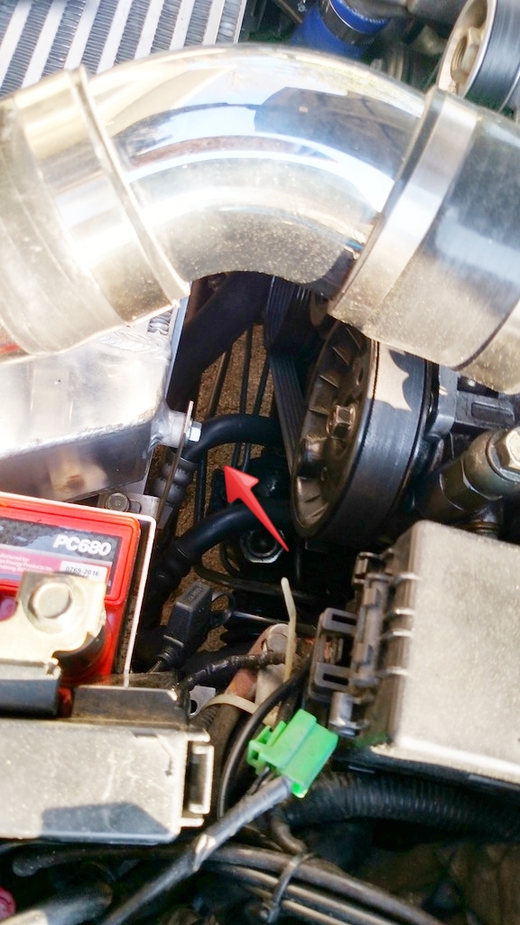

It is hard to get a good picture but this is the line that is kinked. ( upper line where it turns 90 degrees)

if that cooler hose is one for the front cover you might have the wrong one. the one from the r1(duel oil cooler is about 6 inches longer)and the single oil cooler is shorter. got one if needed.
This is the part i used.
Is this the correct part?
https://www.atkinsrotary.com/store/9...2-14-710D.html
