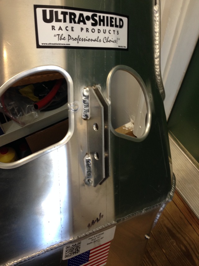

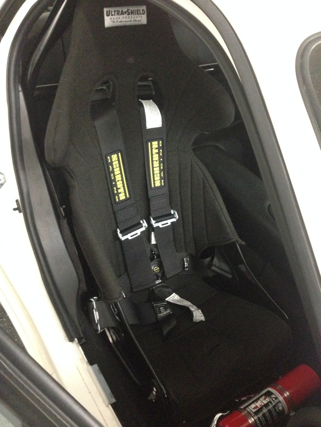

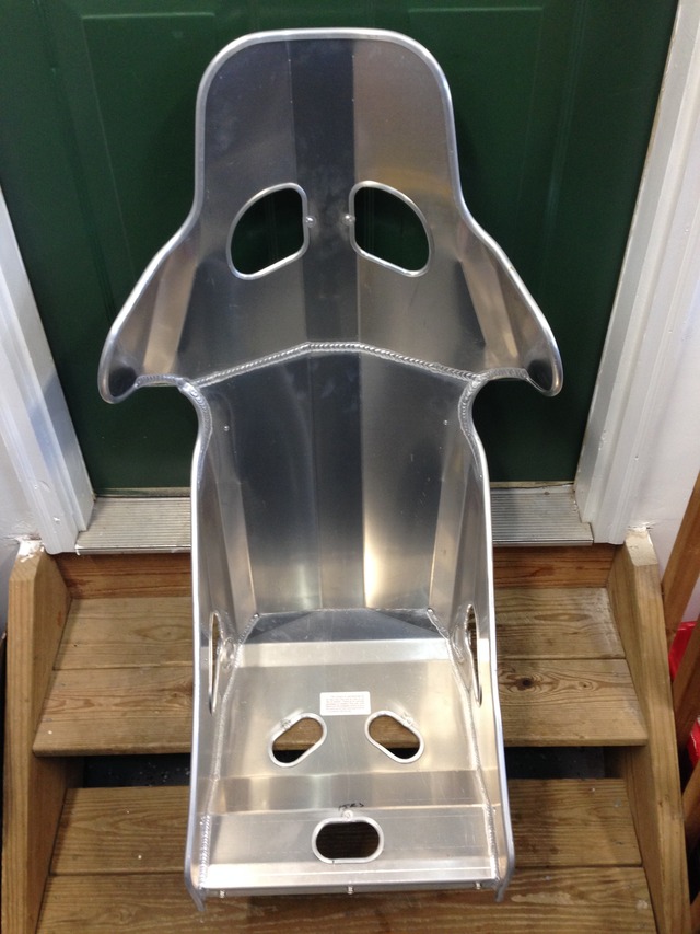

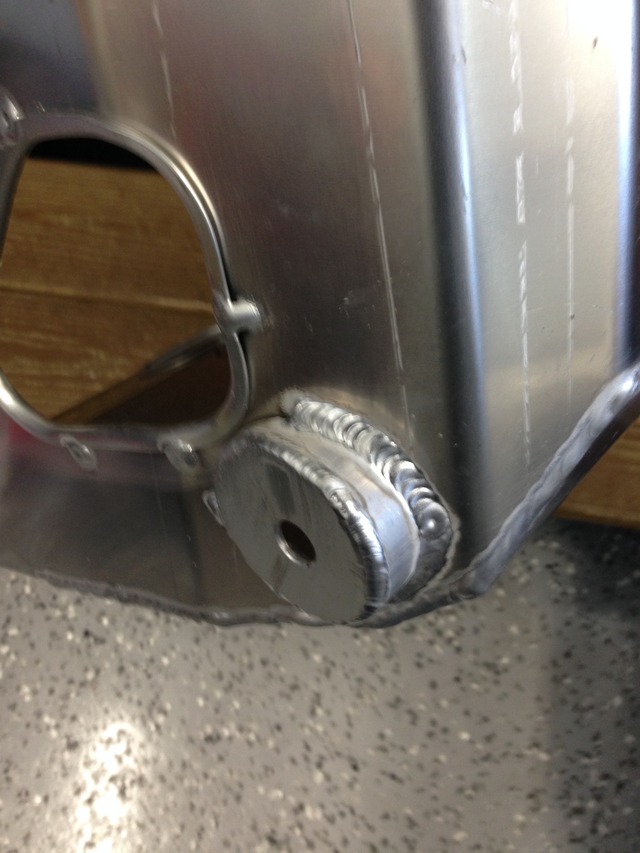

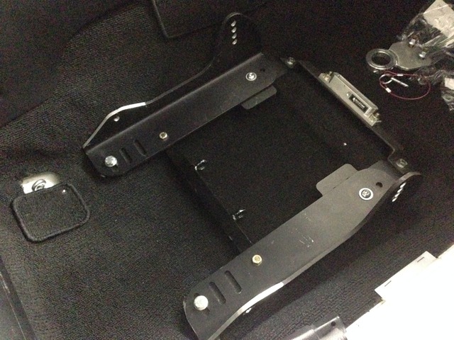

Got the seats installed in the new car. Using atomic Rex mounts that were cut down to fit the seats better and a cross bar added with the sub strap mounts. My drivers seat is a 15". I previously used a 16" and I think you could squeeze in a 17" with possible minor modification. When I had the 16" it cleared the door panel and trans tunnel. You have to mount them tight to the trans tunnel like any seat in order to stay centered with the steering wheel.
Stock seat
Seat modification to fit the rails. May not be necessary if you paired Kirkey rails with different bottom mount.
Seat back brace modification
Drivers side seat mount. The bottom pan will basically sit right down on those back bolts on the floor mount. You can see the cross bar for 6-point sub straps. The bottom mounts use the factory holes.
Driver's seat mounted. I had the seats powder coated black.
Passenger seat mounts. You can see the fire extinguisher mount at the front.
Passenger seat, harnesses, and fire extinguisher mounted.
Close up if the seat back brace.

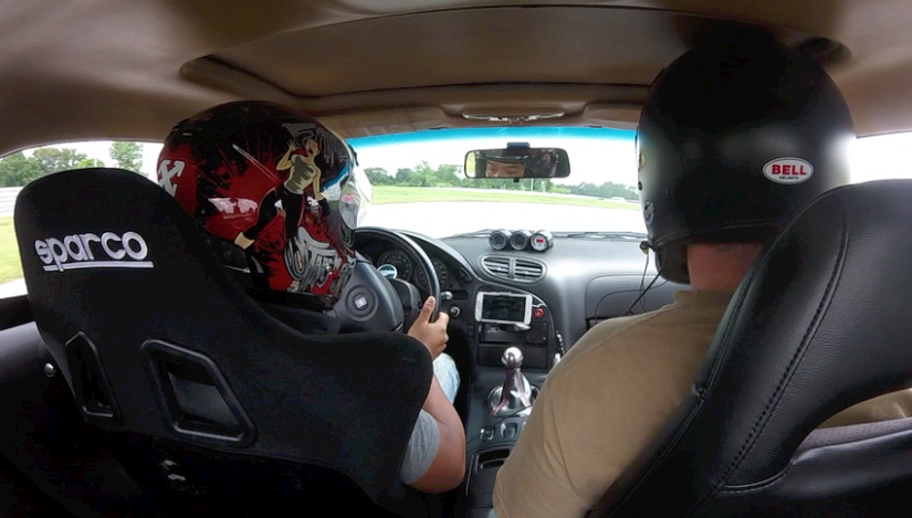

sparco evo in a touring with seat cushions removed. got the seat pretty much on the floor. Name:  Screen%20shot%202016-06-05%20at%202.32.10%20PM_zpsistue6bj.png
How low did you get it? Can you tell me how high it is off the floor at the 6-point holes?
Less than 10 cm?
And are the shoulders the same width?

I would buy another Tillett in a second if they'd just make one with a 20 degree layback. 30 degrees is just too far back for Japanese cars unless you've super short legs or ultra long arms. As low as you can sit in a Tillett, there's no need for so much layback.
Turns out that you can't use aluminum seats without a seat back brace... guess I'm gonna have to spend three times as much an order an FRP seat from the UK. Or get a Sparco Sprint L (by far the most economical option) and pray to the FSM that it actually fits and that I can actually get it mounted low enough.

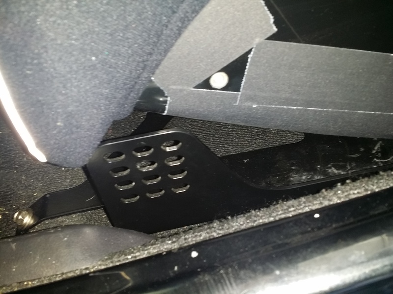

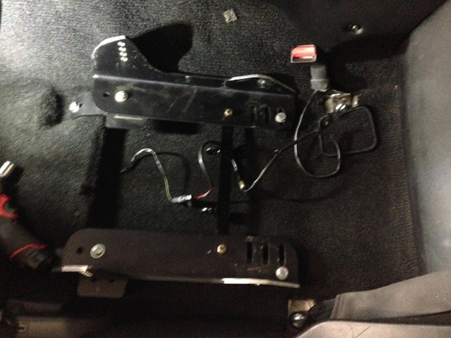

I did some test fitting with the OMP HTE-R 400 today, and the super low seat rails I got from Adam Griffith that bolt the seat directly to the floor. Adam said he'd modify the rails for me to work with these seats. The seat has to be to the right a bit, against the tranny tunnel, otherwise the door is still somewhat difficult to close against the shoulder bolster. The rail kept the seat from leaning down too much, so it's leaned back quite a bit. The upside is it gives even more headroom with a helmet, I don't have to take the bottom cushion out. But I'd still rather not have it lean back that far.
Obviously I had to take this pic outside the car because the *** was back too far to see with it inside the car, and I only took this pic so I could draw on it lol.
Old Jul 25, 2016 | 03:14 AM
  #525
Valkyrie's Avatar
Posts: 5,164
Likes: 167
From: Japanabama
Having it leaned back a little bit is a good idea since it gives you more hold under braking.
