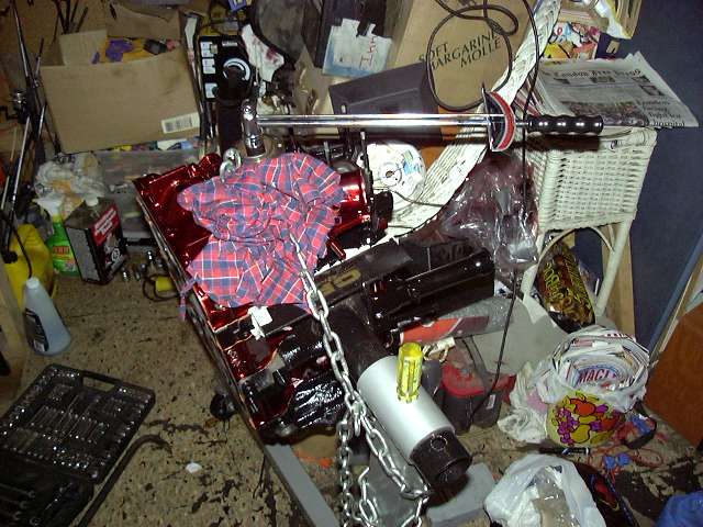

I realize this is pretty old, but I have a question. How do you get the front nut (forgot what it's called, the 90 ft/tq one) off without the thing you made? Once the front cover goes on it doesn't seem like the whole screw driver thing works anymore... Would you pretty much just need to use an impact hammer?
Old Aug 7, 2012 | 03:30 PM
  #44
Aaron Cake's Avatar
Engine, Not Motor
Posts: 29,798
Likes: 128
From: London, Ontario, Canada
Getting it off is easy. Just use an impact gun after heating it to release the Loctite. If you don't have an impact, then you need to loosen it before you remove the flywheel so you can use a flywheel locking bar to hold the engine from rotating.
Before I made that little tool, I've used a chain to hold the front hub from turning:
Holy cow... Is that a janitors closet?
hehe still bigger than the room I rent where I built mine.
EDIT: Nothing like sleeping with your engine parts prior to building.
