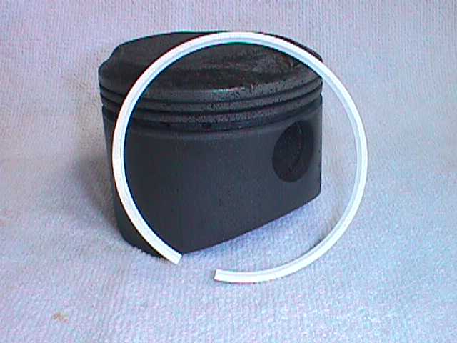

carbon fibre piston out of a Porsche 912 ceramic piston rings

i can't seem to find any actual info on the custom porsche block that you are showing that piston from ^
it'd be nice to read an article about it rather than just see the picture.
and as i had mentioned, they are most like not using the conventional woven carbon fiber that you may find on your car exterior/interior parts
You sure that's "carbon fiber" or "carbon-carbon"?
There's a BIG difference!
-Ted

We have experimented with "Carbon Carbon" pistons here at work (NASA) on a small block Chevy and a v8 diesel of some sort (both n/a). These were carbon carbon and NOT carbon fibre/fiber. They all had a ceramic-coated tops to prevent them from self destructing themselves. We had one of the pistons on the diesel engine go bad one day during testing. The ceramic top or piston face had cracked from thermal shock or not adequate clearances, I don't remember (was a cold 28 *f morning when we started up the engine). Once the thermal ceramic top coat failed, the piston quickly deteriated. I still have the piston somewhere here, its got a HUGE hole in it from were the diesel fuel was injected and burned. This project died, so I don’t know how much this type of research has progressed, it was 6 years ago for us here. I tried to talk them into doing a rotor...LOL.. that was a no-go. I don’t have a whole lot of info on it (but I still am friends with the now retired employees that did work on it), I was a grunt for that particular project and just set up the water brake, mountings, wiring, fuel, etc and running the engines, I stayed out the engineering bit of it. All the stuff mentioned by other posters were found, tighter clearances (less expansion) which resulted in quieter smoother running, the oil temps dropped ( the carbon carbon held in oil much better, was a thermal barrier (non thermal conductive), and the ceramic top coat further kept combustion temps in the chambers and not absorbed by the pistons. Reciprocating mass of coarse dropped dramatically in the diesel (heavy iron pistons to begin with). Both engines gained effiency resulting in more power with better mileage and running cooler (I dont recall how the EGT's reacted)

Carbon-carbon is carbon fibers in a carbon matrix
