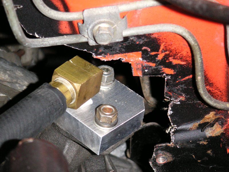

Why can't you use the RB bypass block? Do you have a beehive oil cooler or something? I wasn't supposed to use the bypass block on my 20B, since the stock filter pedestal also has a banjo bolt in it, as do FD pedestals. I simple drilled and tapped my bypass block for a barbed fitting with an oil line that is the same internal diameter as the stock line.
