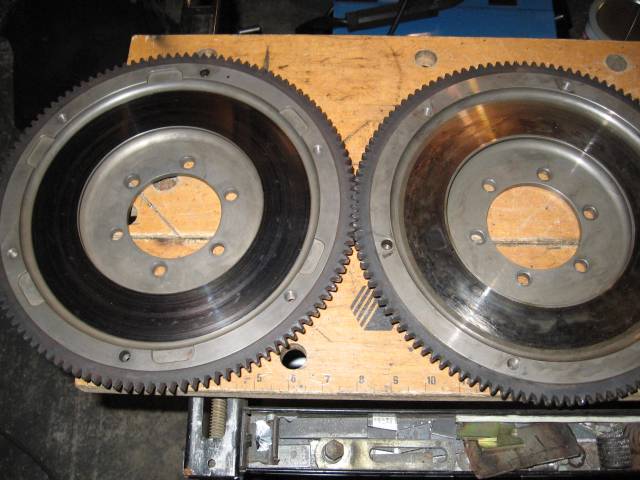

I just gained access to enough clutch parts to do my REPU and my S model. Two RB light steel flywheels, two street strip pressure plates and one stock 225mm disc with almost no use (over 8.7mm thick). I'll pick up an HD disc (no springy marcels between friction surfaces so it grabs harder than stock like Steve uses) or another stock disc.
There is a catch.
One flywheel is the early type with no clearanced sections in the upper lip. it is only compatible with 215mm pressure plates. If you try to use a 225mm pressure plate, it will work for a little while until the rivit heads come in contact with the upper lip. Then it's slip city.
Can you tell which is which from the picture?
There is a catch.

Of course I'm talking about the flywheel on the right.
With this type of flywheel, you must use a 215mm pressure plate. The rivits are up a few mm higher and will actually work.
Kinda sucks that you can only use the less total grip capability of 215mm components though. However, you have a choice between a 215mm disc or a 225mm disc in this situation. How is this possible? It is possible because the flywheel surface is flat out to 225mm and then it starts to curve up. This means you can use a 215mm pressure plate with a 225mm disc and get up to 220mm of grip!! Wows!

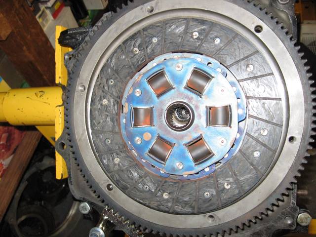

You take the unclearanced RB flywheel
and a 225mm disc

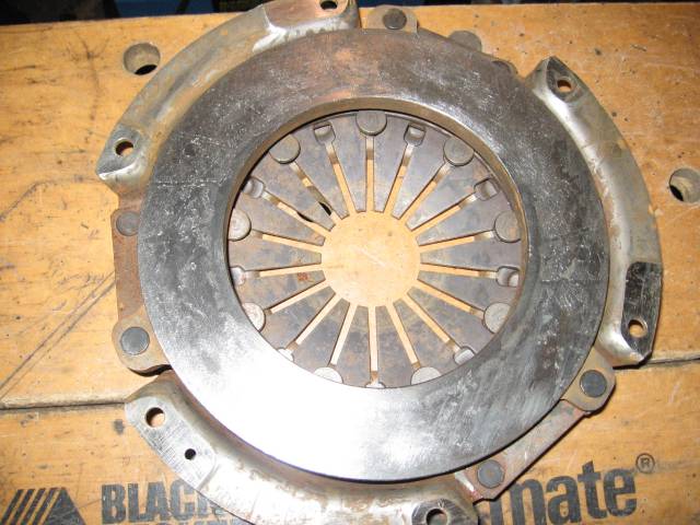

here is a typical 215mm pressure plate (don't look at the rust)
and here it is bolted down
the 5mm excess is clearly visible, but not detrimental
You can also see that the rivit is plenty high above the flywheel lip. This setup will run for years and will offer slightly more grip than a fully 215mm setup, and slightly less total grip than a fully 225mm setup. A compromise that works.

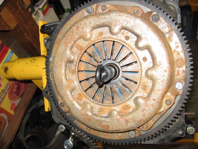

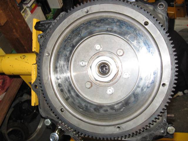

I have no pictures handy of the backside of an RB flywheel, but I do have some pictures of a superlight steel flywheel.
The front (or back lol), so you get an idea of what I'm talking about. These only came in 215mm and are super thin. Notice it even has a little clearancing notches although it isn't really needed with 215mm pressure plates as far as I know.
Check out how thin this thing is!
One more pic kind of showing the back side.
If yours has thick starter teeth, it's RB. If small and thin, it's this super light aftermarket one.
