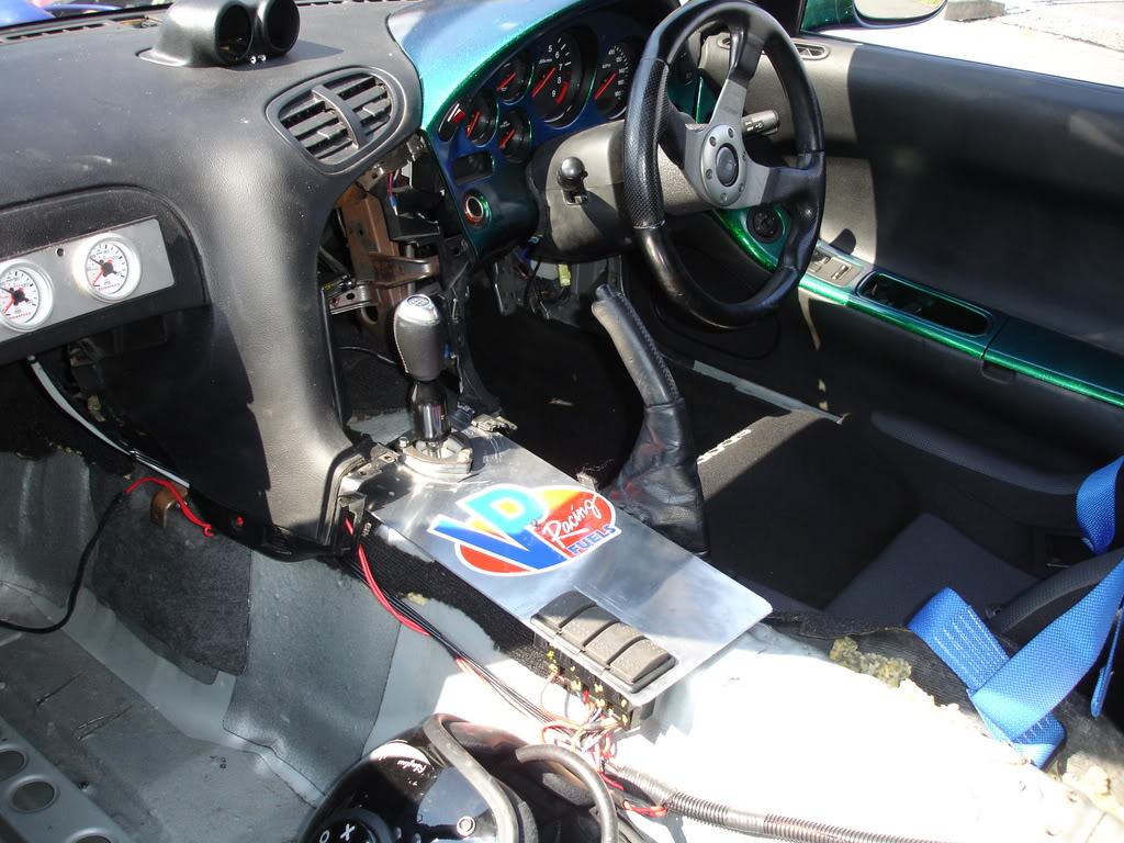

This picture was taken by me at Rotorstock4 in Santa Pod this year.
I don't know what they did to fit the gearbox in, but as you can see the gear **** sits a lot closer to the firewall now.
I asked the owner of the car, and he told me that the RX8 gearbox is stronger than the RX7's.
His car wasn't just a street car, but a stripped out drag machine, so I'd say that he knew his way around cars, but the comment about the RX8 gearbox surprised me.
That guy is smoking crack! The RX7 tranny is WAY stronger. The RX8 tranny is just a miata tranny it’s weak as crap it barely holds the rx-8. He probably just has the RX8 shift **** on it.
Either way it is a bad decision and does not bolt in. 1-2 gears are closer then the rx7 tranny and 6th is about the same as 5th so basically you just move one and 2 closer and why would you want to do this on a turbo car?

^^^alot of people use the rx8 shift **** in there fd's cause of its comfort and grip. theres no way to prove from that picture, that its sporting an rx8 tranny
