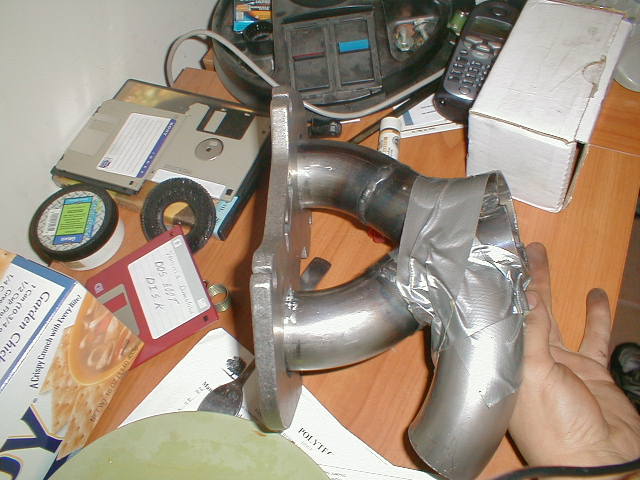

Well, I had a friend TIG the manifold piping for me today. All the welds look pretty good except for a small part (<1") of one, which had some crap on it, so it's a bit porous. I'll have him go over that again tomorrow i think. The only other bad thing is that we didn't really brace the manifold much before welding, and it warped just a bit (the "Y" got about 1/8" narrower). The result is that it doesn't quite fit into the flange, so I think i'll just bend the insides of the runners out a bit (it's really, really close). I forgot about this... The guy who welded it usually doesn't do too much with tubing, so he didn't mention it either. Oh well, no big deal!
Here's a pic...!
Here's a pic...!

Well, I got the runners into the flange, but i'm stuck on the fact that they're a good bit off centr (there's a ~1/8" gap on the outside of each hole of the flange (towards the front / back of the engine). This will overlap with the exhaust ports, which I don't like, but It may be the only way to do it for the time being. I may end up splitting the runners near the flange and 'stretching' them out to get rid of the gap... we'll see!
Anyway, I was playing around with different locations for the wastegate runner, and came up with a couple of options...
It looks like it'll be possible to put a curved piece under the collector, heading back, but this puts the runner within about 1/2" of the motor mount, which can't be good for the rubber. It also makes routing the dump tube back into the downpipe much more 'interesting'
So, my favorite spot at the moment is putting an elbow on the rear of the collector, right before the turbo flange (at a 90* angle), that points down and towards the rear corner of the engine (more or less). I attached a pic of the mockup (more duct tape... wahoo!
). Is that placement going to work OK, or will it send me spiralling into turbo-rotary boost control hell?

Is there anyway you can place the WG tube more center so it sees both exh ports better? What if you placed that 90deg fitting on top of the collector? How is your turbo going to sit on the manifold? Is the turbo flange going to be parallel with the engine flange or perpendicular to it? like mine is? As you can see I'm not too much farther than you and am still tring to make my WG runner decision like you
-Cam.
-Cam.

Hey setzep, nice looking manifold!
The turbo flange is more or less parallel with the engine flange (it's actually tilted a bit up / in at the front, to clear the smog pump and shock tower better, but it's just a few degrees). As far as the wastegate runner goes, if I put it on top of the collector then it comes within 1/2" of the intake manifold, and gives clearance problems with the downpipe. Putting it directly under the collector gives pretty good clearance everywhere except for the motor mount, which is within 3/8" or so. This wouldn't bug me too much, except that the motor mounts seem to go pretty quickly without the added 'benefit' of 1600* heat next to it
. The way it is on the side won't be too bad I don't think, especially since the manifold is undivided.
I'll take a look at it tomorrow again and see if there's a better way to route it that I missed. I plan on building another manifold after this one anyhow (out of stainless hopefully, and with slightly better fit / finish), so if this ends up causing problems I can always revise it later
Yours is looking good! It looks like you have a bit more room to play with too, so hopefully you can get a slightly better location for the WG runner.

I don't know If I'd worry too much about the WG runner being 3/8 inch away from the motor mount all that much. Remeber the WG runners aren't going to be running near as hot as the main runners. Or maybe you could make a little shield to protect the mount?
-Cam

Welllll.... I think i'll do that on manifold #2
(I, uh, just came back from grinding out a nice big hole in the manifold in the garage, for the wastegate runner). Once I get the downpipe set up, i'll have a better idea of how much space I have down there too. I remember now another issue with that was that it would have put the 'cold' side of the WG quite close to the DP (within an inch or so). Of course I could wrap the DP too, so I guess it wouldn't have been that big a deal!
This manifold is sortof to play around with a bit, and get some numbers from. I'm thinking of installing a pair of little pressure gauges on the manifold runners (via long tubes
) and monitering the backpressure in each runner with and without the WG open. That should give a pretty good indication of any problems induced by having the WG runner there.
In a few weeks I'll be at this again, this time with Stainless. I just wanted to be sure everything would work before I dove into it with expensive materials!
-Manolis

I got the WG runner tacked on today, and made the Turbo Flange. It's almost there!
Here's a pic of the thing:

Looking pretty good so far. I think the WG runner being on the side will work fine. It might be better on the top or bottom, but unless you are running very high boost levels, your design should work nicely.

*phew* thanks. I was worrying about that a bit
I still think that it'd be pretty cool to plumb in two pressure sensors, if for nothing else then to see the backpressure:boost pressure ratio. That would be interesting I think!
Now to finish welding this thing and make the intake piping, etc!

Looks good! Your passing me up. Now that I look at it again I woulden't worry about the WG placement, I bet it will work good. All the wastegate does is bleed off pressure anyways, doesn't really have to have a nice even flow like the main runners do to the turbo.
I do have one concern though. With your turbo being mounted that low on the engine how are you going to run your turbo drain line? Looks to me that it's going to almost have no down slope to the engine.
-Cam
