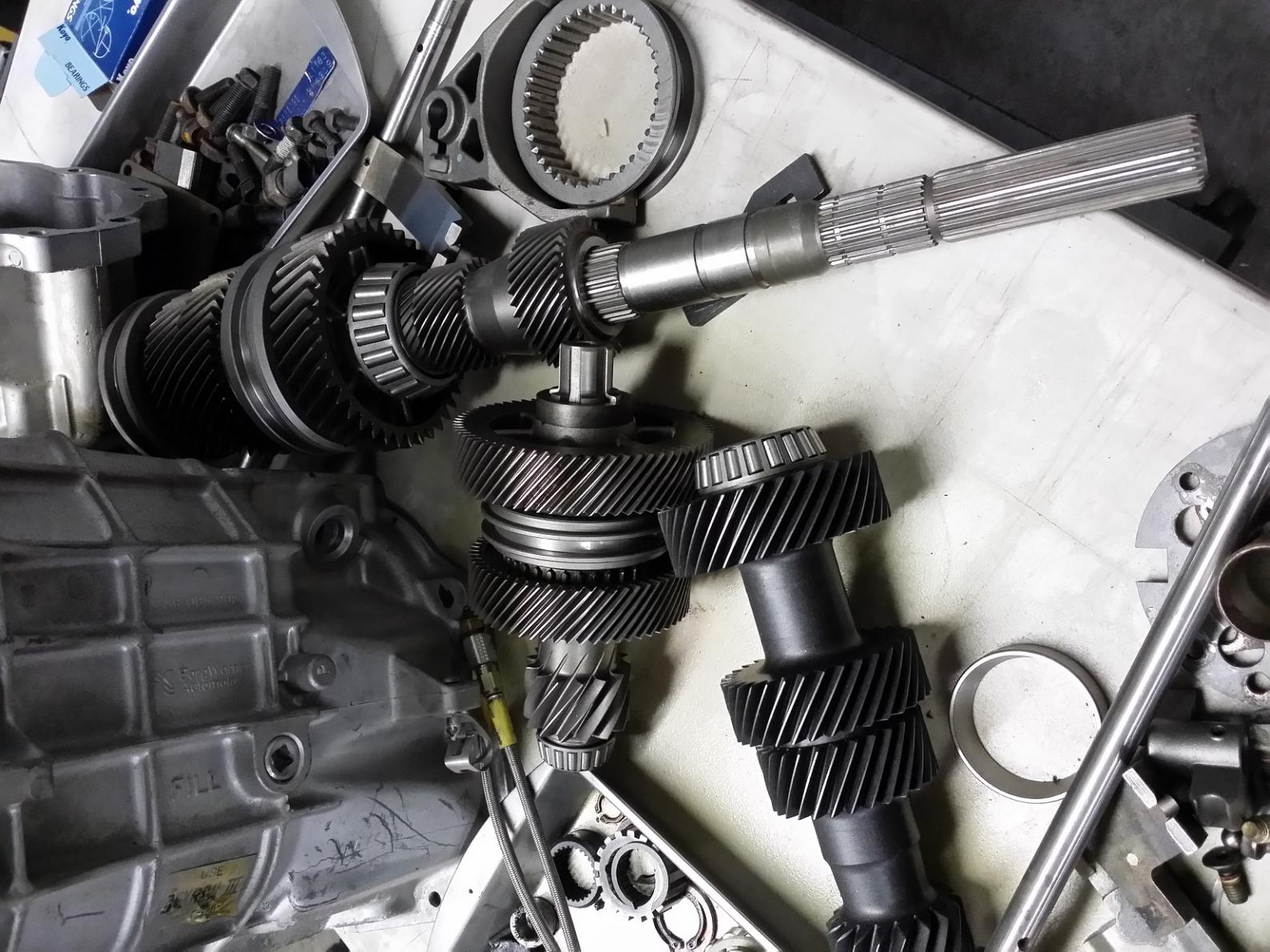

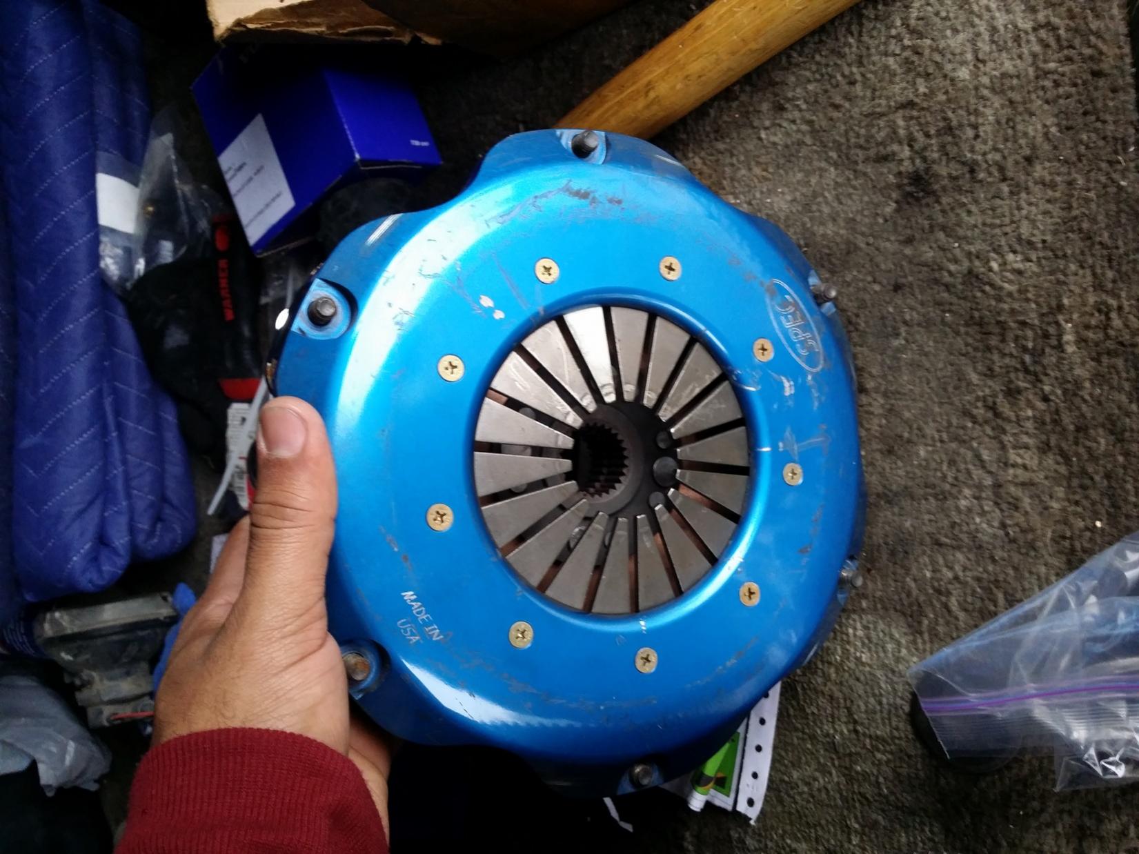

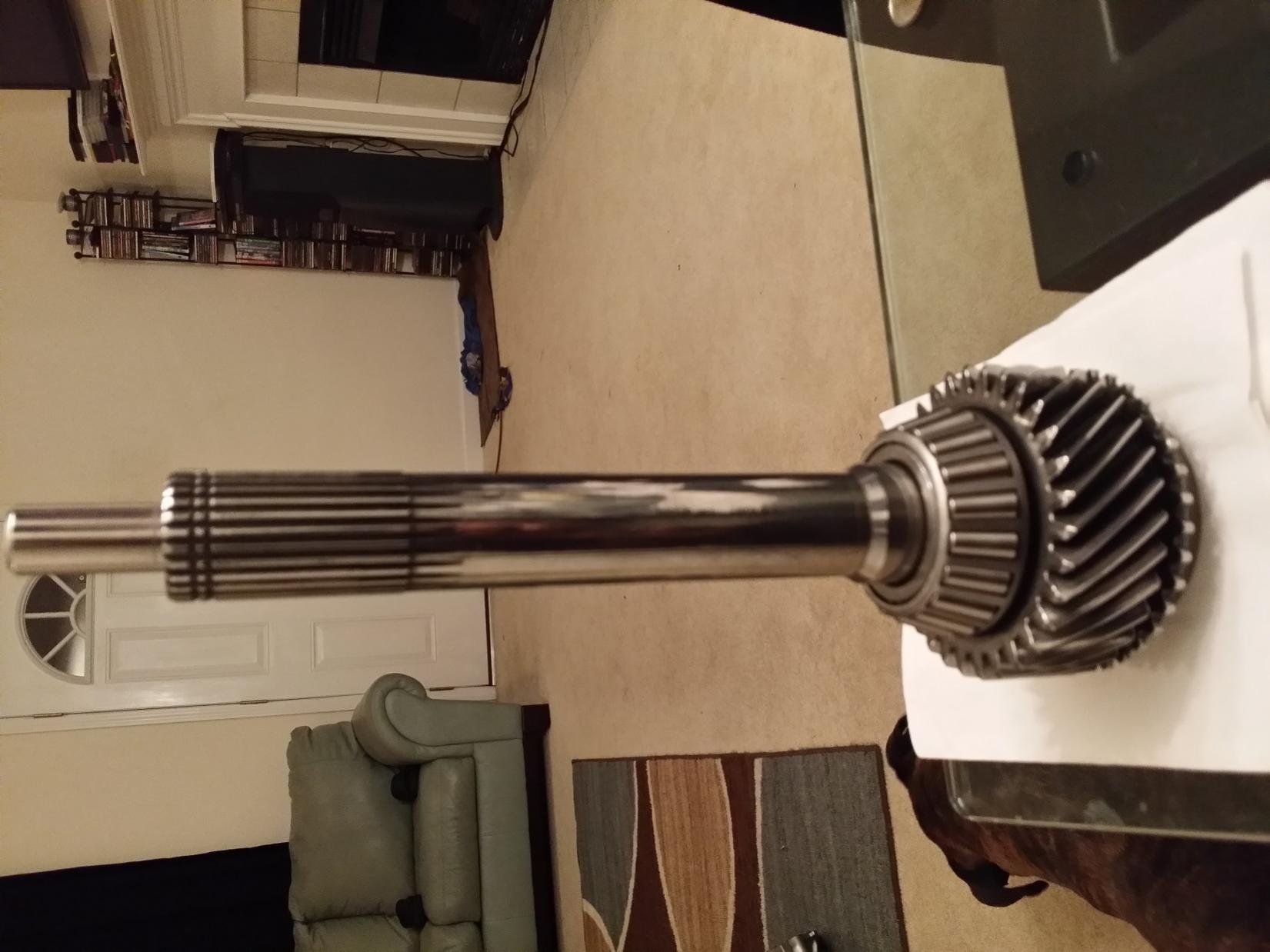

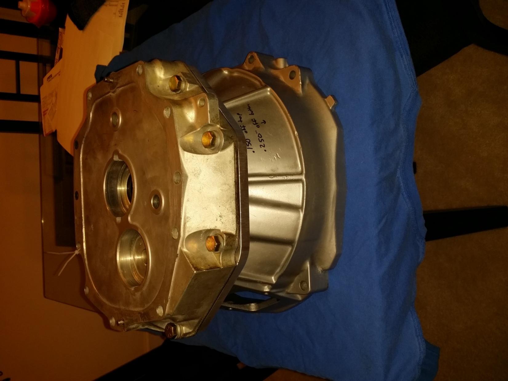

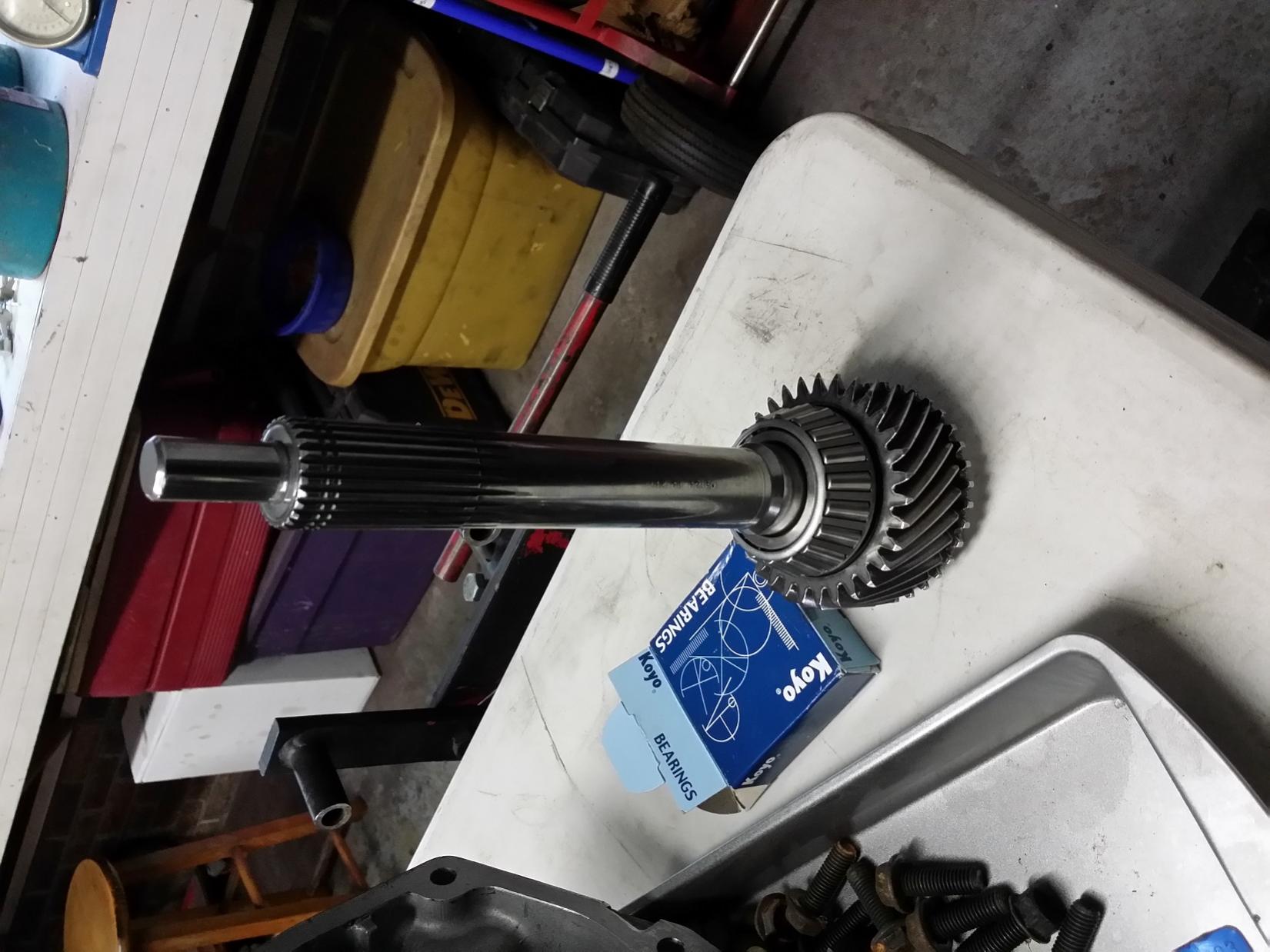

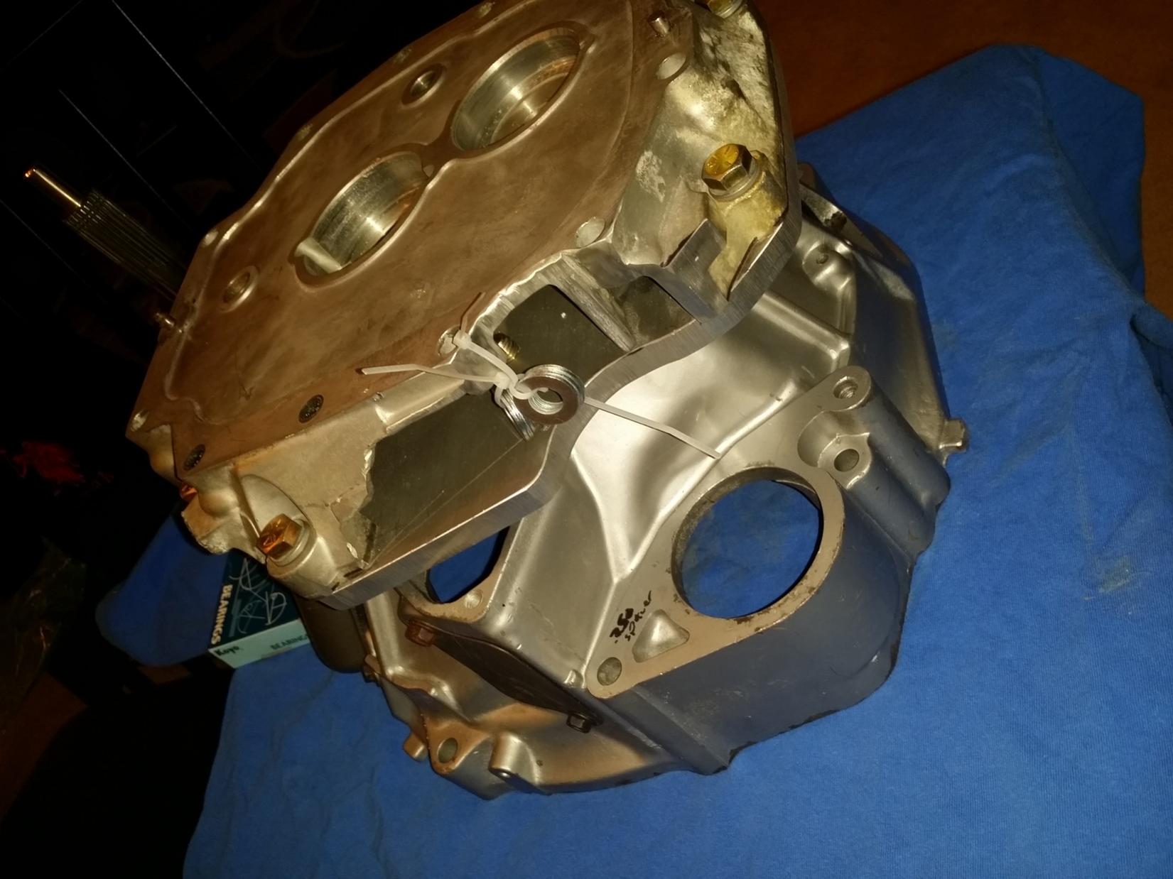

"I have a small update on my swap.
Just a quick notion as to why I'm swapping. Good or bad I needed a solution. My car makes 500ft-lbs and I've ripped 2 trannys apart and 2 diffs as well. I just wanted something more beefier. Maybe this will help maybe it wont.
I bought a kit from a forum member. He had a few issues and didn't want to deal with the headache of it all. Couple issues were evident from the beginning. The adapter plate had been cut using a torch, which warped it ever so slightly. So the shaft was grinding on the bell housing collar, making an ungodly sound. Next, we drained the fluids and it looked like we struck gold. Metal shavings all thru the oil. Once opened things weren't so bad. But the main issues were the use of old parts. So the trans was rebuilt, but they used the same gears, same synchros, and they just replaced the parts that they were upgrading... like the keys, forks, blocker rings.
I have thrown everything away and bought new gears and everything else. I got an adapter plate from gforce. Very disappointed in their customer service and time promises. Said 2 weeks. Well I gave it to them in Nov, just got it back a few days ago. Yup. But this is what they did. I sent in my input shaft, the spacer plate from the t56, and my stock fd3s bell housing. They shaved the bell on both sides for input shaft penetration, kept my new input shaft and sent me a used viper shaft, sheesh. Said it's better. Ok buddy. I have pics of everything so far. I can't upload them from my phone. But I can send them to someone and they can upload them.
But when I'm done I will do a write up with pics and everything.
And I have a really small ***** "
