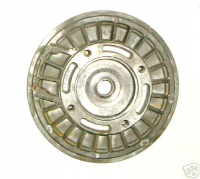

or this dynamic or carbon?

Originally Posted by cjbechtel
okay.... so what is the visual difference then? do you know if this would work?
http://cgi.ebay.com/ebaymotors/ws/eB...category=33742
Going by the compressor measurements, it's an H-trim compressor wheel.
http://fc3spro.com/TECH/TURBO/tmodels.html
It's a dynamic seal.
See the bronze colored "C" part in the middle?
Right under it is the dynamic seal.
The compressor map at the bottom of the auction shows a V-trim compressor map.
Weird...
-Ted
