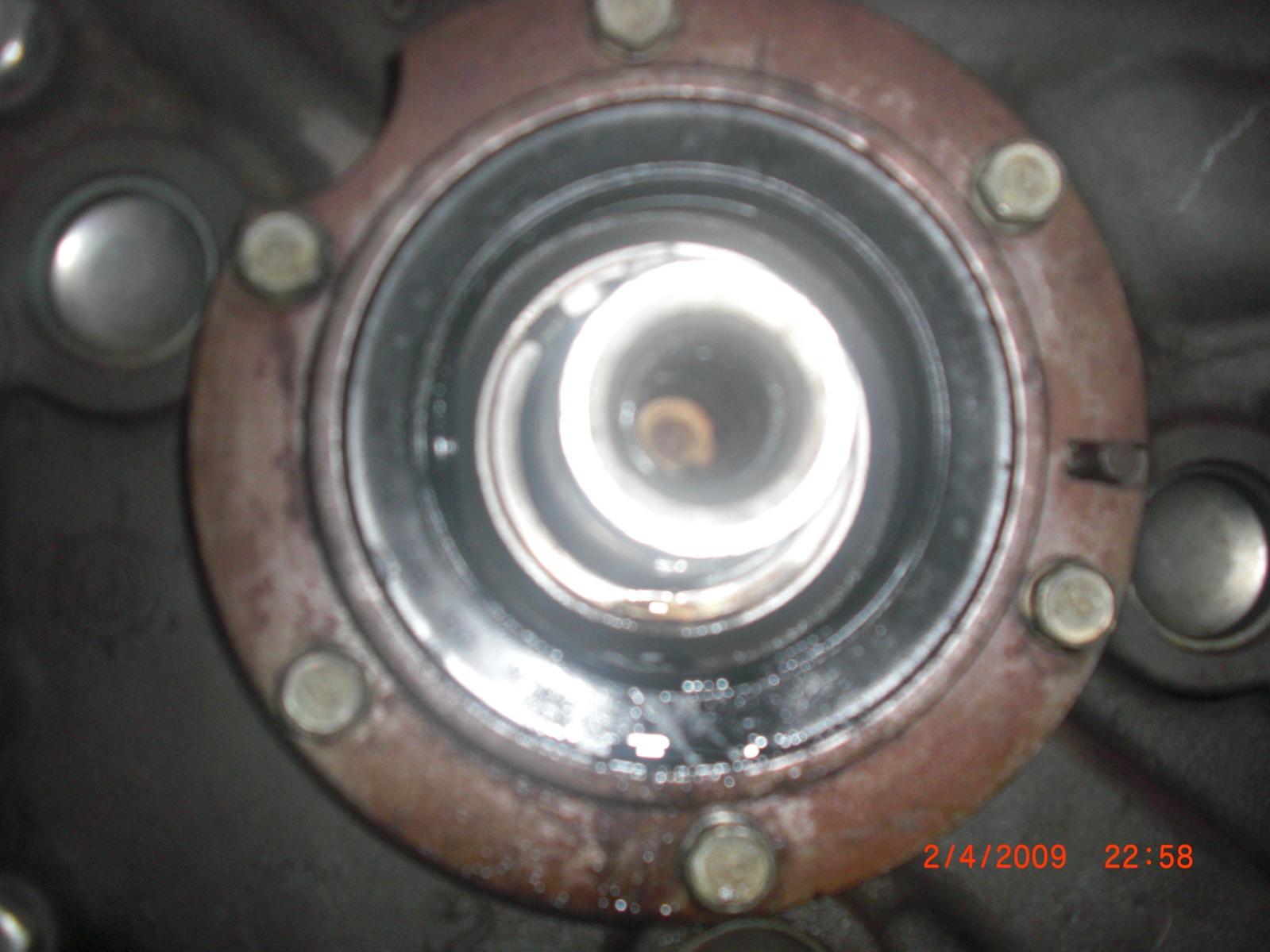

So i started on the replacing the seals today and when i took off the flywheel i noticed the old pilot bearing and thought that i should go ahead and pull it out. That was at about 1:30. Its 8:30 and i just got it out! I have NEVER had one be that much of a bitch to get out. I used my pilot bearing puller and my slide hammer and it still took 4 eva. i finally got it out and i feel like it really coulda been my problem the entire time. Im about to post some pics of what i mean.
The first pic is not that great of a pic but its the pic i took before i started to remove the pilot bearing

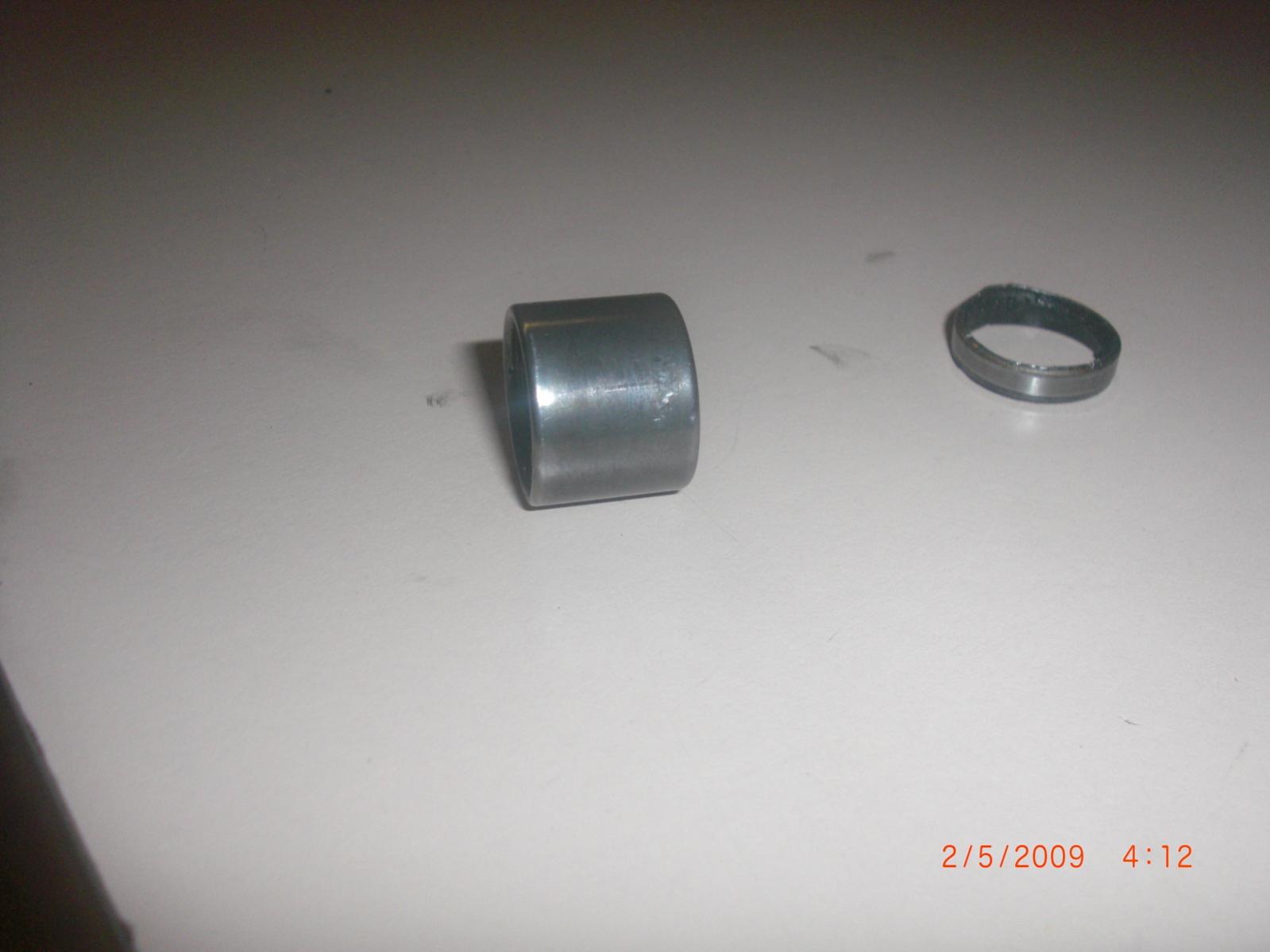

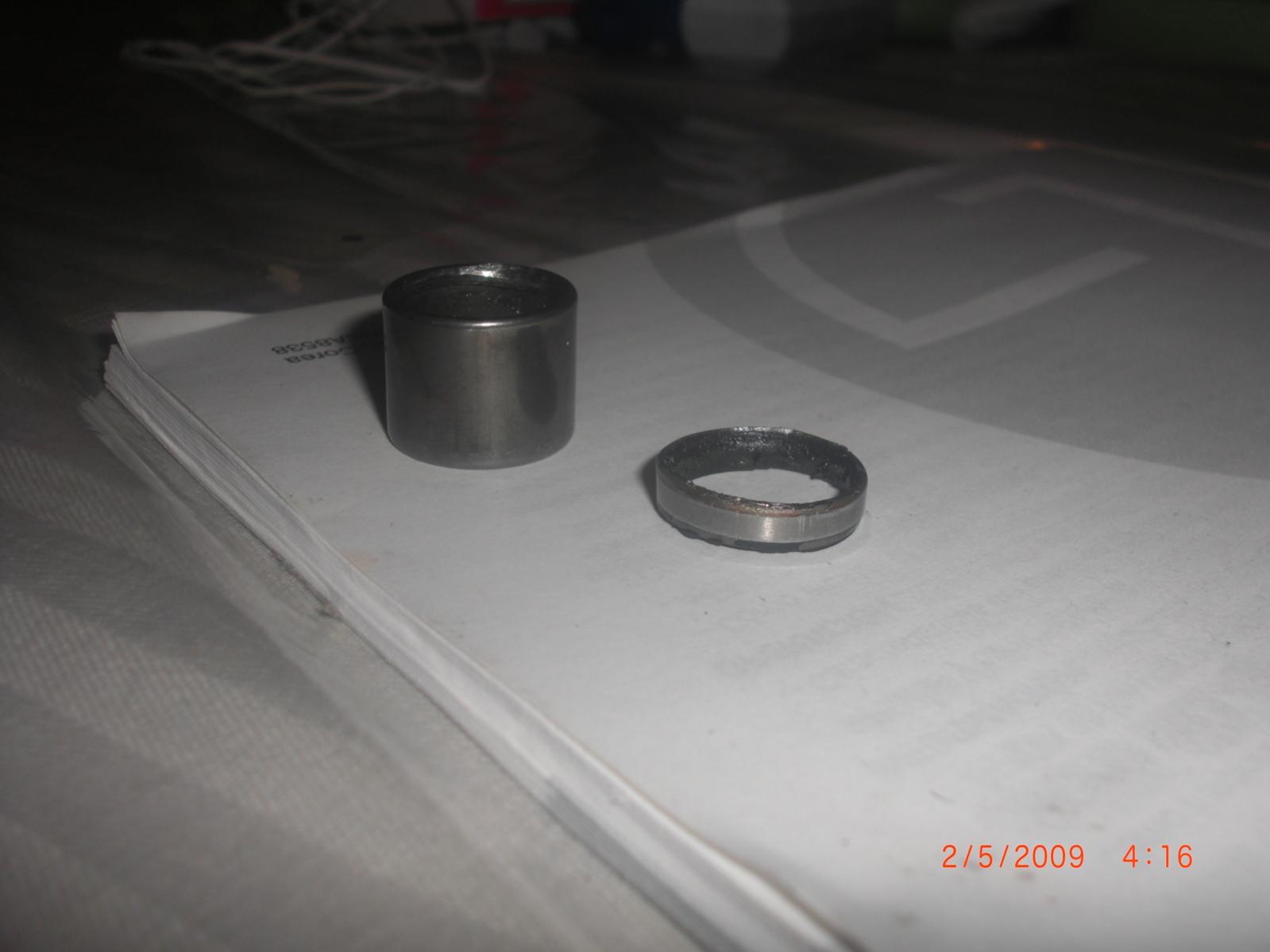

The 2nd pic is the pic after i got the pilot bearing out. The piece on the left is the actual pilot bearing but WTF is that crap on the right?
It was kinda jammed in front of the pilot bearing and it looked to be pretty damaged. I dont have a clue what it is.
The 3rd pic is just another shot of the 2 pieces that came out. Where these pieces attached at one point? i cant tell but it sure doesnt look like it. Has anyone else had anything like this?

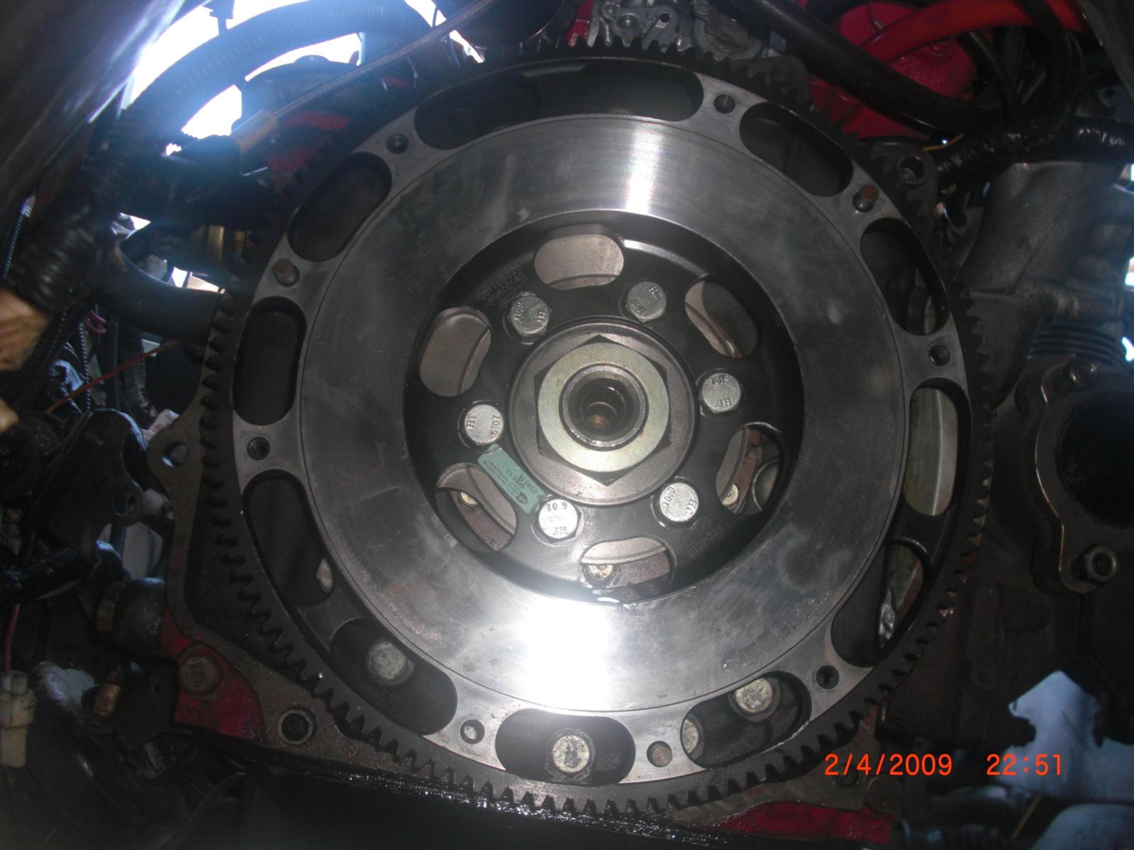

The last pic is just a shot of the act flywheel and counterweight installed. This really shoulda been the first picture... My bad.
It was kinda jammed in front of the pilot bearing and it looked to be pretty damaged. I dont have a clue what it is.The 3rd pic is just another shot of the 2 pieces that came out. Where these pieces attached at one point? i cant tell but it sure doesnt look like it. Has anyone else had anything like this?

The piece in front of the pilot bearing is the pilot bearing seal. Some people run them and some people don't.
A busted pilot bearing will let you shift when the car is off, but not shift when the car is on.

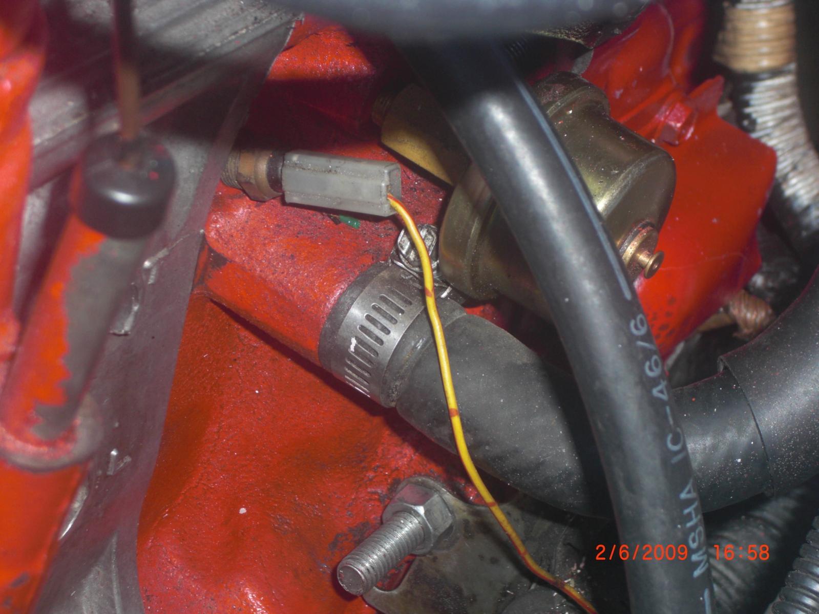

So i was looking for the wires that everyone talks about thats right below the oil filter and oil pressure sensor. I found the red/yellow wire. it looks to be connected properly. It is pictured first. Is this one for oil/water?

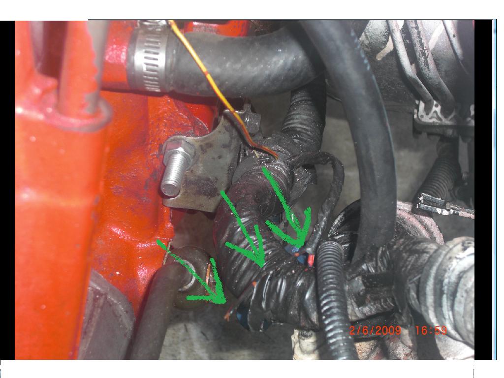

The second pic is a black/red wire that i have no clue as to where it belongs.(big green arrows) Its obviously broken. What is it and where does it go? Could this be the wire that is supposed to be grounded on one of the slave cylinder bolts?

See that Thing that looks like a Bell,beside that yellow/red wire in the picture?..that is your Oil sender..the clip is not on it(not hooked up,so you got no wire to the Sender,therefore your oil gauge is not reading).
