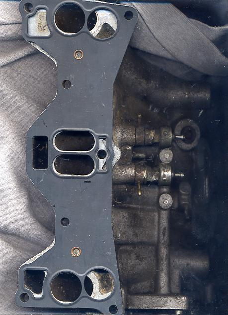

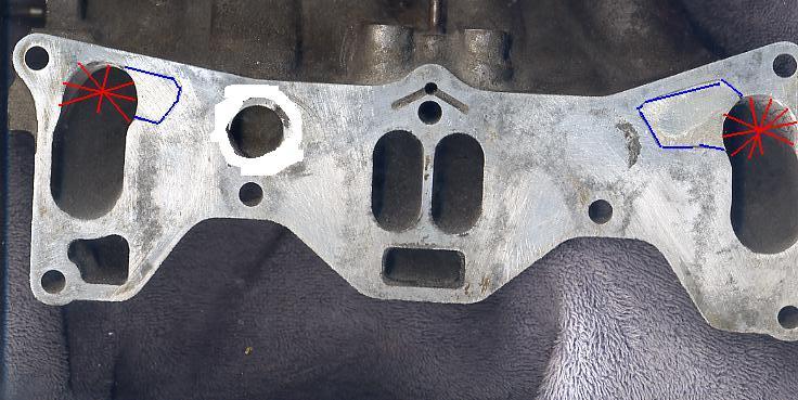

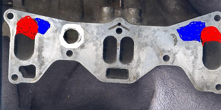

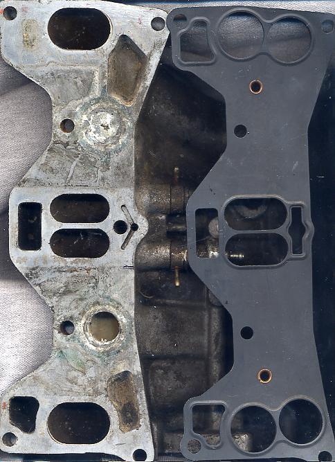

Far right shows the turbo manifold and the non turbo Gasket.
Second from the right shows non turbo gasket laid over the turbo manifold.
Second from the left shows????? I think I colored those areas in to show someone how much needs to be cut out on the turbo manifold.
Far left is the solder filling the Blue areas in the other pictures.
I filled the intake holes with sand. Lots of paper first then the sand over the last part near the area to be filled. Uses a propane torch and a metal cup. Melted the solder.......poured the solder as just one pouring so it'd be one mass of solder.
Cooled down and cleaned up the area around the intake holes and filed the solder level with the intake face. Something like that. I dilly dalled with that for over a year 'cause there was nothing wrong with the engines in the cars I have. Did it for UNKNOWN reasons, even to me. Just something to do. Been driving it for two yrs. Passes state inspections and another inspection coming up....when I feel like getting it and not before.
I shoulda poured the solder prior to gutting out the intake area. I THINK I did it assbackwards. Fill the BLUE area first.
For an intake gasket I made my own out of gasket paper from AutoZone. The thick stuff with rubberization in it. New word..rubberization.

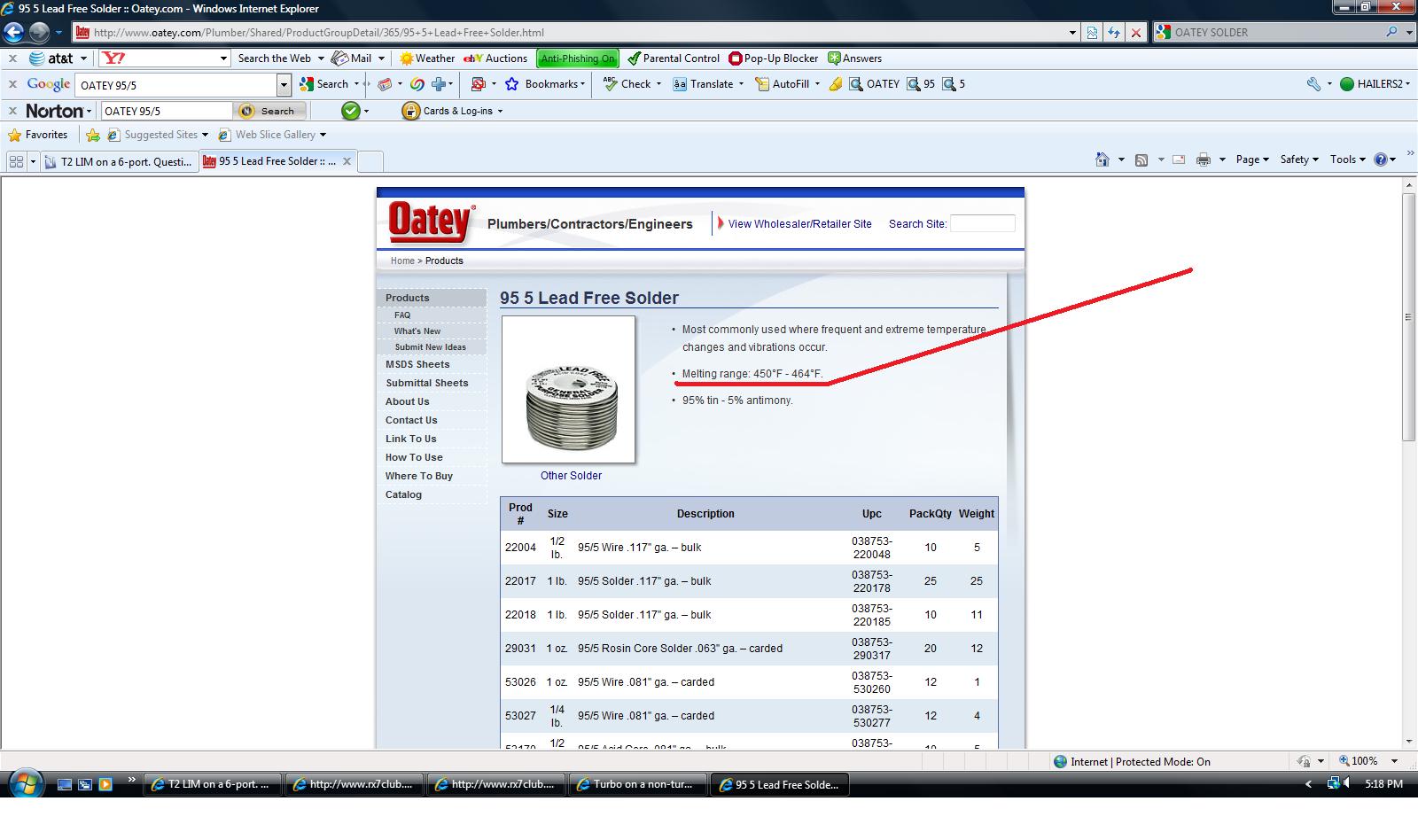

This thread and on the second page. I didn't read it all again. I'm looking at a roll of that solder and the paper tag is missing but imbossed on the plastic spool the solder is wrapped around, it has "OATEY". Says it has 95% tin, 5% antimony.
I remember looking it up online and finding the melting figure given in the link above.
I think I'd buy a roll that had the 95% tin on it. Others have 50//50 other *stuff* in 'em.
