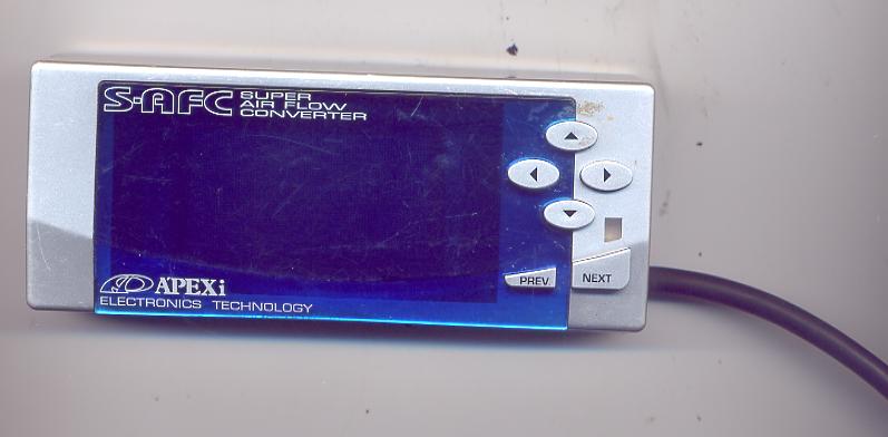

HAILERS's Avatar
HAILERS
Posts: 20,563
Likes: 27
From: FORT WORTH, TEXAS,USA
http://www.zeitronix.com/
http://wbo2.com/
And buy a SAFC to lean it out.
Personally the cheapest way I found to make a n/a go faster was by doing something similar to this thread http://forum.teamfc3s.org/showthread.php?t=106
That said, I've a 86 na and I like driving it as a stock n/a. It's a different driving experience than driving my turbo cars and I enjoy it. I think because I can work(drive harder) the car more than I'm allowed to with the tubo cars. Can't explain it better than that.
Attached Thumbnails T2 injectors on N/A-safcone.jpg
