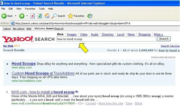

Originally Posted by FC3sinfiniIII
By any change does one can tell how to do body work on my hood such as to put the t2 hood scoop replica on?
http://www.mx6.com/forums/showthread.php?t=76541
http://www.3.8mustang.com/forum/show...ing+hood+scoop
http://www.omnilith.net/teamomni/scoop/
