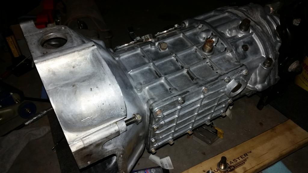

From what I understand, the S4 and S5 are not very different externally. There's an extra bellhousing bolt or so, a bulge in the tail section to accommodate a balancing weight on the output shaft, and different transmission crossmember as a result (on the S5). Internally, very different ratios.
What's confusing me, though, is the bellhousings. bumpstart points out that the S4 bellhousing is actually not separable from the main body of the transmission
https://www.rx7club.com/2nd-generati...sions-1053147/
And my own S4 transmission pretty much agrees

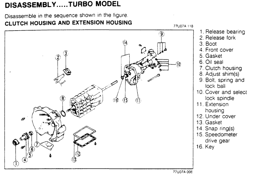

But the FSM says otherwise? (http://foxed.ca/rx7manual/manuals/1988FSM/07a_MANUAL_TRANSMISSION.pdf)
Granted, my car is an 87 model and the FSM is for 88 models. But does anyone knowledgeable want to chip in?

pzr2- INTERESTING!! That must be from a real early T2, as my S4 box here has a replaceable bell housing. The early T2s had plenty of odd ball mech stuff- diff stub shafts stuck out ~3/4" further, thus = shorter axles. non-interchangeable turbine housings w/ later 87 & up housings, odd coolant "AST" tank up front...
