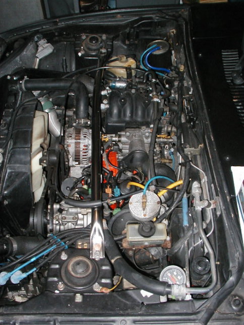

steve sweet looking engine bay . where did you get the peice that replaces the stock rubber elbow just before the intake at the end of the intercooler piping. in my picture i use the rubber one.hidden behind all the stock crap.haha
i definetly need to do this mod, first time the intercooler piping blew off i thought i blew the motor . i called my brother all depressed and told him he can have my car if he got a new engine, he came over looked at the engine compartment and just started laughing histerically .

Yea,the stock TB elbow was the first thing to go when I got my front mount.I never liked the idea of making a 180* turn in the intake tract.
Its from a guy on TeamFC3S.They are CNC machined,very nice quality.Cant remember his name,but Ill try to find it.
