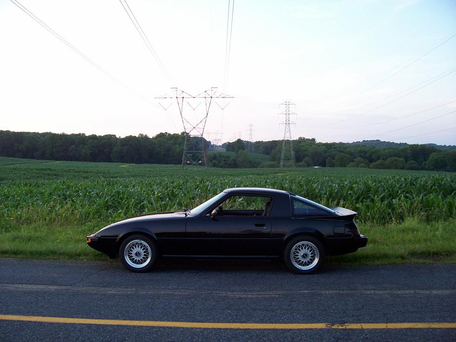

You will need 25mm spacers up front to keep them from rubbing on the springs, otherwise they fit and look great. Attached is a pic of my T2 83.
82transam that 7 looks sweet

Yeah they do fit it quite well. A bunch of things have changed on my car since the pic earlier in this thread, one thing you guys might want to consider is spacing the rear's out a bit too. You need 25mm up front to clear the springs and this makes the front noticably wider than the rear. I ended up using a 20mm spacer in the rear with longer studs. So far no issues, although they do rub on some bumps, will need to roll the fender lip a bit.
