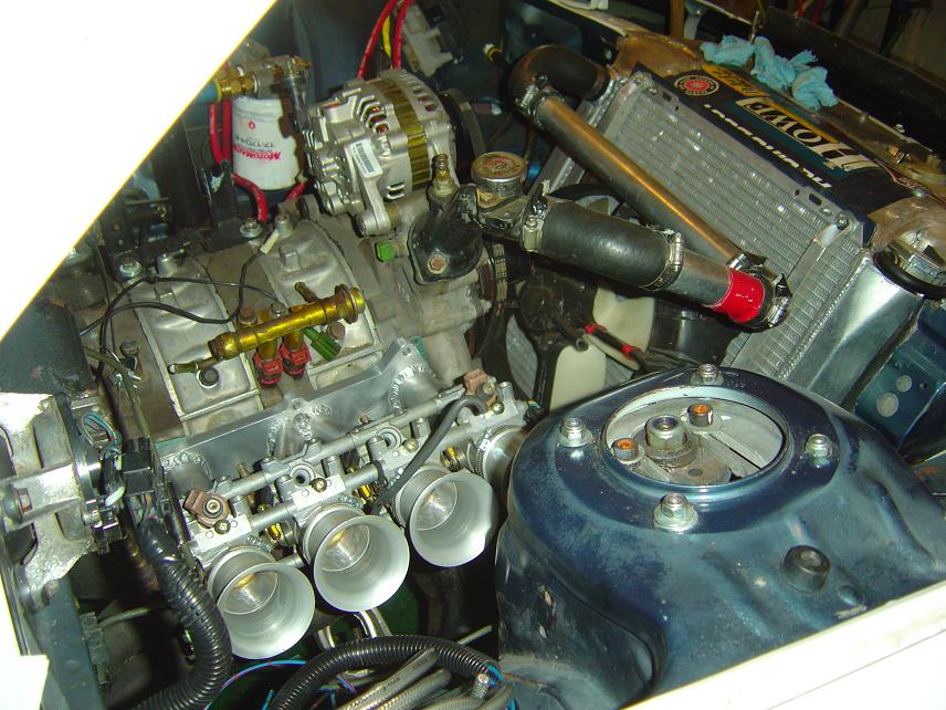

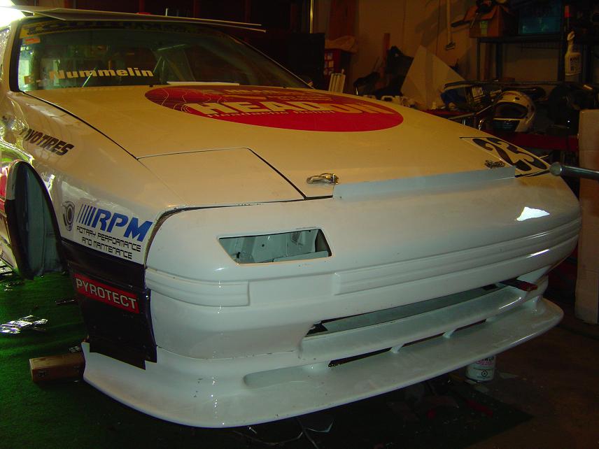

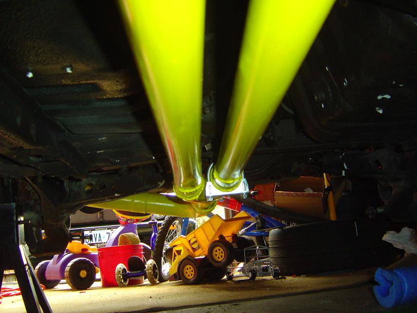

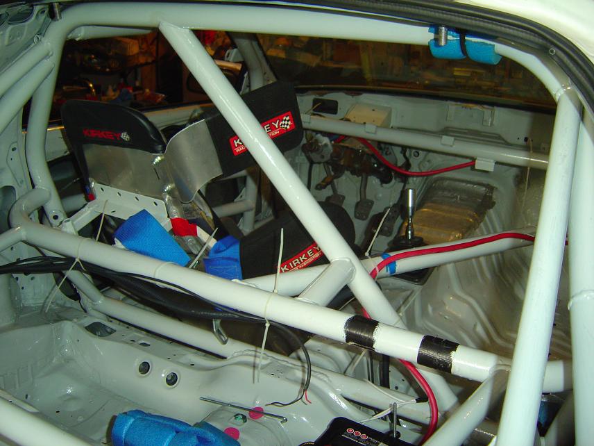

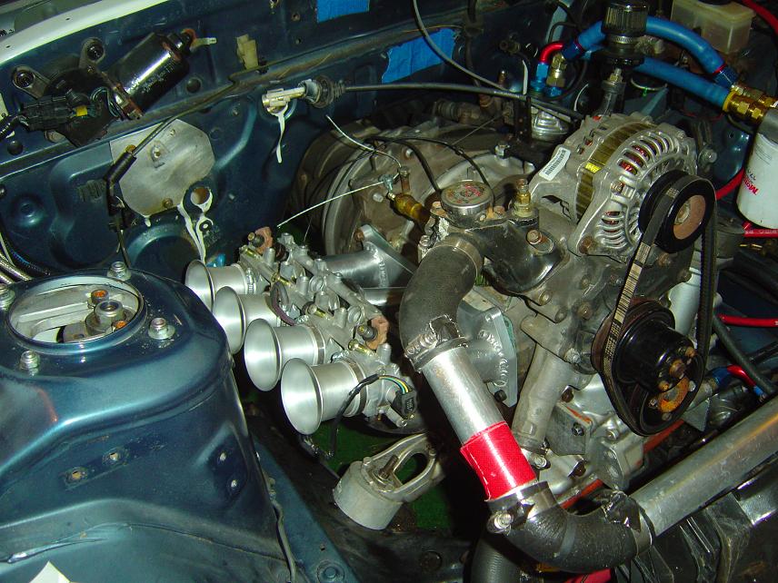

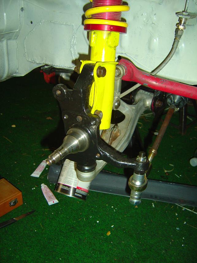

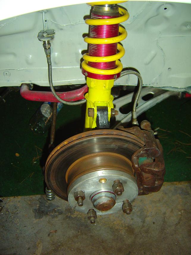

Build shots from Friday. We are getting there and Dave is most of the way done with the wiring. Once the wiring is complete I can assemble the rest of the car.
Pain in the butt on the front suspension. Worked out the bump steer on one front wheel. Matched it to the other side, then found out my tie rod / rod ends are too short. Need to make new extenders. Also need to get the fuel rail changed. Need to find a good Aluminum welder. May be out to see your next door neighbour Joe.
Everything else is just bolt together and if I can find somebody to paint the nose, hint hint..... It can all go together. Hope to be on the dyno early the week after the long weekend.
Its all a bit messy right now but going together nicely.

Like I said, we need to create a fuel rail and bolt everything together but we are over 75% of the way there. Need to be ready for the June 2/3 rd Shannonville Long Track CCTCC Race.
It will be a race just to get there in decent shape.
This is what I was doing today instead of lapping around Mosport, but it looks like everyone had a great time.

these stories are great.
so race car drivers can't get those 17mm strut bolts off either. glad to see that's not just me! i hate those bolts (hitting them with the torch didn't do it for me).
oh, and how long are your primary exhaust lengths before it collects? seems pretty long.

As you can see from the pictures, Dave started the weekend only having the heavy cables routed. He worked for about 4 hours Sunday and routed about 80% of the smaller wires. It looks great. Everything is routed through shielded cable, when it needs to be, it uses Mazda connectors and silver coated wires. Awesome stuff.
I spent some time fabbing on the throttle bodies. I installed 2 vacuum ports into the 2 center injector ports. I am going to pull vacuum from both of those ports to use for the brake booster. I may need to add an accumulator to get a consistent pedal. I am also going to create a new throttle cable mount as the ITBs pull a little further towards the rear. I still need to get some alum welding done to extend the stock fuel rail by about 2 inches.
Dave and I decided ages ago to use stock Mazda stuff where possible as it adds some reliability and bolts together well. The best part is if we have a failure we can get some spares from a dealer. I have tons of spares, but you never know when you may need something at the track.
I am going this afternoon to buy a proper tap so that I can make the tie rod extenders and finally bolt the front end together. The rear suspension is pretty much done and we can now run the rear of the car about 1 inch lower than last year. We had to make new upper strut mounts that locate the upper part of the spring. Based on the upper locator hole, they should be noisy, but do the job very well. We also saved about 4 pieces so the time to change springs has bee reduced a ton. It should only take the removal of 1 nut and everything else should fall away.
Regarding the exhaust, we reduced the diameter of the collector by about 2 inches. This has allowed us to move the pipes closer to the rear subframe and increase ground clearance by 2 inches. As well the reduction of the area inside the collector should improve exhaust velocity and improve exhaust scavenging versus last year. Downside is going to be a sharper exhaust note. The exhaust length is based on the information I got out of Australia to improve torque. We will have to get it on a dyno to see how good it actually will be. Oh well pluses and minuses.
The only thing I have no idea about is the airbox and filter setup. I may have to run at Shannonville with some kind of cobbled together filtering element. Just need the time to fibreglass up the airbox around the mold. Before the next race I guess. One concern Dave and I have is the noise from the throttle bodies. When you open the butterflies and shine a flashlight down the ports you can see right into the motor. It should be really, really responsive, but bark really good off throttle. Not much I can do now but the intake sounds should be spectacular. It is a bit tough putting it all together as nobody else, that we are aware of, is using this type of setup in North America for road racing, so we are breaking new ground.
Anyways, we will see how it all runs.
