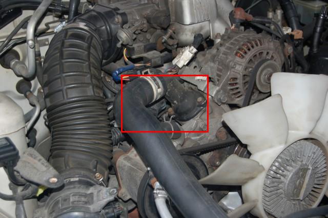

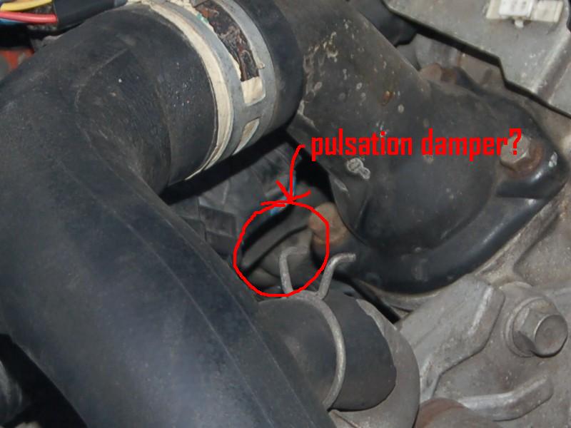

I seem to be the only person here who has had trouble finding my pulsation dampener (damper? dampner?). I don't want to take off all the stuff on top of the engine until I know there is a problem.
I tried to take a picture of what I'm pretty sure is the pd. It doesn't have the white plastic piece on it. I cannot get my hand down there, and I can't see whatever is under it where gas would leak. Would gas leak onto the ground under the car?
It is out of focus in the photo, sorry. It was to dark down there for the camera to focus on it
Attached Thumbnails I think I found my PD-copy-dsc_0629.jpg   I think I found my PD-pdclose.jpg

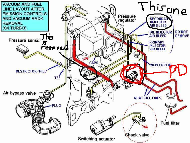

its under your throttle body, you cant really see it unless you take the TB off. On the diagram its the red circle by the fuel filter.

look a little closer at the second picture guys. he found it... i'm not saying he can get to it as is, but he found it.

S5 FPDs are welded to the primary fuel rail. They don't have the white piece of plastic on them as the S4s do. It looks like you found it, but you do need to remove the UIM to get to it.

ok looking at the 2nd pic again, looks like you did find it. Sorry
