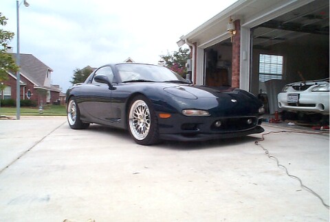

Lowered the 7 today (before/after pictures)
Old Jul 23, 2006 | 04:01 PM
tphan's Avatar
Posts: 886
From: Dallas, Texas

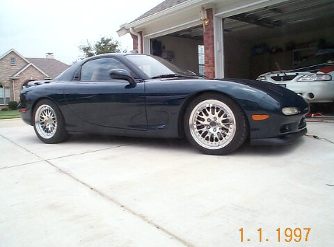

Springs: H & R Sport.
Shocks/Struts: Bilstein HD.
Wheel size: 17x9; 17x10
Tires: 245/40; 275/40
Time to complete: 2 hrs
I think the combo lowered the car 1.5" all around.
Minor issue: 1. Front tires rub inner fender liner if steering fully turned; 2. Front spoiler barely rub steep drive way (ok if go in at an angle).
Over all: Love the look comparing to before. And "TIGHT".

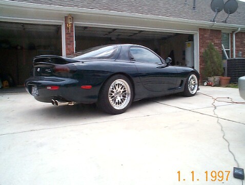

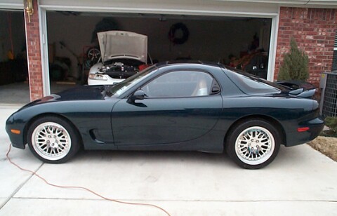

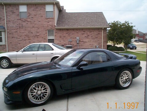

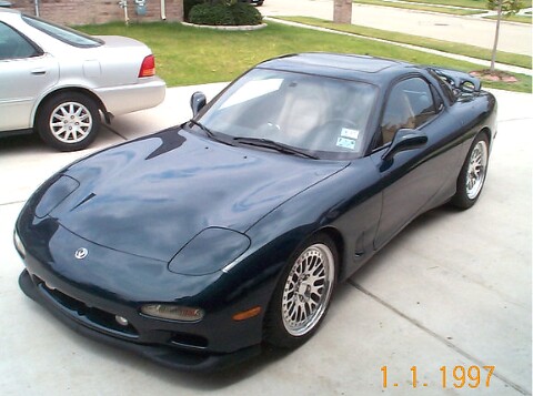

after.
Attached Thumbnails Lowered the 7 today (before/after pictures)-7lower2.jpg   Lowered the 7 today (before/after pictures)-7lower6.jpg   Lowered the 7 today (before/after pictures)-7lower7.jpg   Lowered the 7 today (before/after pictures)-7lower8.jpg   Lowered the 7 today (before/after pictures)-7lower9.jpg

first picture was before (stock).

looks good so far. clearer shots from the side?
best side picture.
Attached Thumbnails Lowered the 7 today (before/after pictures)-7lower3.jpg

just came back from a drive...and it is rough on back road ( I like), but handle great on S curves and hwy.
Do have tire rubbing inner fenderwell line on tight right hand turns. Woud 235mm tires for the front help?
