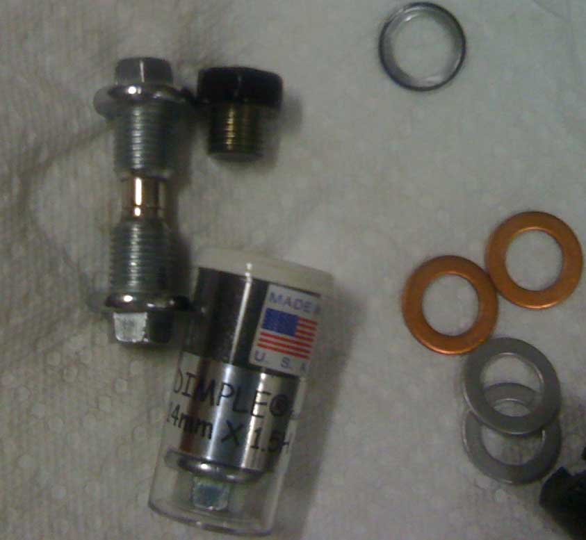

Finally got around to test fitting the different oil drain plugs. The one from HyperGarage fit perfectly. The threaded portion was the same size as stock.
The Dimple one I got from DrainPlugMagnets.com did not. Its too long and interfered with something when I tried to thread it into the pan. It got aobut 3/4 of the way in. Check the pic to see the difference in lenths.
The magnet on the Dimple one is ridiculously strong! Much stronger than the HyperGarage one. I asked the Dimple guy if he is interested in making one that fits the RX7.
Attached Thumbnails Magnetic Oil Drain plugs - options and results-drainplugs.jpg

Thanks for the info. A plug from Dimple that fit our FD's would be nice.

I've been working with Richard, the owner of Drainplugmagnets.com to make a drain plug for the FD (and other RX7s and Mazdas that use a similar style plug).
Learned some interesting info about the magnetic oil drain plugs in the process. Figured I'd post here as an FYI. I'm feeling less enthusiastic about the Hyper Garage one now that I've learned a bit about oil drain plugs. The heat ratings in particular concern me since we all know how hot turbo rotaries run. Especially when you track your car like I do.
The fancy looking products you are looking at are aluminum plugs with the magnets pressed in them. Aluminum expands faster when heated than the magnets do......Magnets have been known to come out of aluminum plugs under certain conditions, not good.
All my drain plugs are steel only. My magnets are extremely strong but like most magnets brittle. The further in they are the more protected they are from dropping, etc. My magnets are not pressed in, that could cause internal fracturing. They are epoxied in with an epoxy good for 500 degrees. Bulletproof. If you have a steel pan, it is easier to put in and take out without the magnet trying to stick to the pan.
Trust me, the low profile I will be sending you is great. No clearance problems and easier on you trying to put it in and out. There was a lot of thought put into a Dimple® for the customers sake. Oh, my magnets are super high temperature rated, they do not loose their magnetism at 175 degrees F, A Dimple is good for over 300deg. F . They cost more, if somebody does not mention high temperature.....they're not.

I am sending one of the plugs that I received over to IRP so they can take a look at the product and critique. Ihor and Rich have seen many more oil drain plugs than I have so it will be good to get a professional's opinion.

Pic of the Dimple drain plug w/ stock drain plug. I tried to do a side by side pic but the magnet on the Dimple drain plug would just pull the stock plug whenever it got within 2" of it. Definitely a strong magnet!

He definitely will be. These will probably fit the FC, RX8 and Miata as well. I have been slow to test this since I recently did an oil change using some nice $ Idemetsu and am reluctant to dump it any sooner than I need to. Especially since I don't get paid to do this.
I sent a second plug to Rich/Goodfella for his testing but I don't think he's done it yet on his car (for the same reasons as me). Not sure if he did a test fit on other cars at the shop...
Anyway, I will probably wind up installing after the holidays in January. I'm 99.9% certain it will fit. It was the same dimensions as the stock drain plug.
