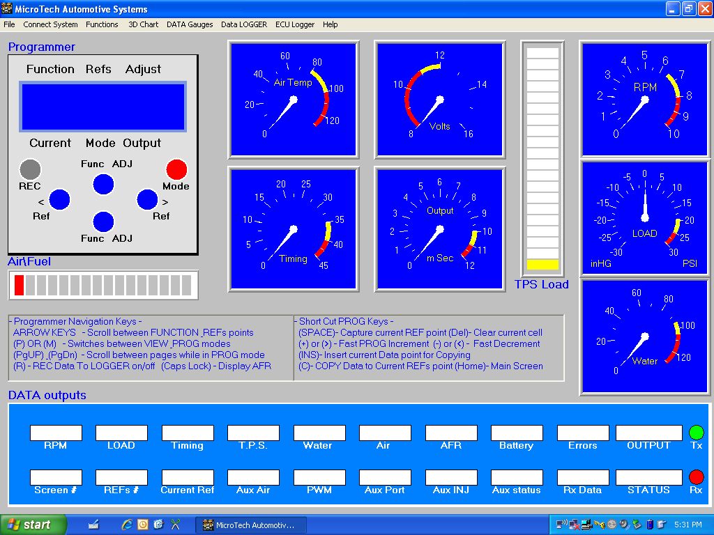

I'm trying to start my car after the big turbo upgrade but cannot get connected to the ECU. When I try to connect, the Microtech software screen simply "freezes". All the values at the bottom blank out, and the gauges don't respond. I've included a screenshot.
The car does want to start as fuel and ignition are firing, but I can't troubleshoot why it is not running without being able to connect to the ECU.
If I disconnect the laptop and key on, the fuel pump primes and the TPS light responds as it should (lit at zero throttle, goes off at more then zero throttle).
This whole thing worked last year before I put the car away, but now suddenly I cannot connect.
I also did a serial port capture to try and find out if my machine simply had a bad serial port, but it looks like it can see the Microtech just fine. Here's a paste from the serial capture on the DCE side:
Attempting to move through the menus to the data gauges or through any of the screens resulted in no response....
HELP! I've waited 6 years to drive this car and am now stopped by a non-problem.

Nevermind, I'm an idiot. I forgot the laptop adapter. Apparently it had fallen off the end of the serial cable and I didn't even realise until I found it in my laptop bag.
