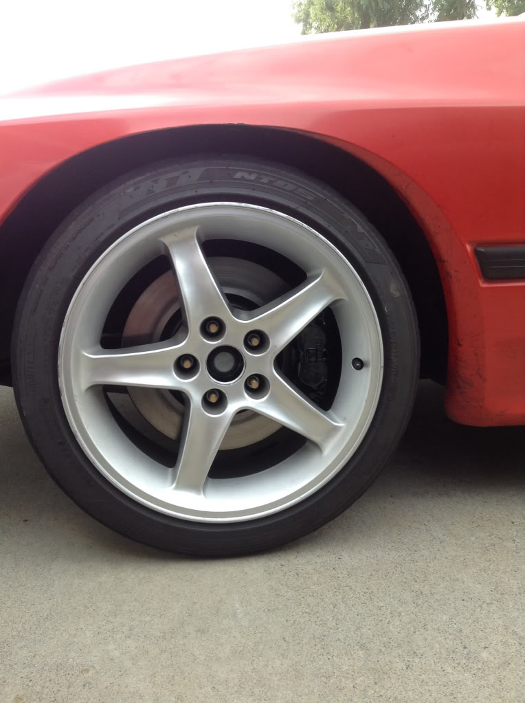

What more do you need out of the brakes?? What pads do you run? The T2 setup is actually pretty good. You can upgrade it by running a Ronin Speedworks Mandeville front brake setup. It allows you to run 350z front rotors. I have this setup on my car.
FC Mandeville Brakes
17 inch wheel on my car:
You probably just need more agressive pads. When did you fluch the fluid last?
Drilled and slotted rotors do nothing, don't waste your money. FD calipers are the same as FC calipers basically.
