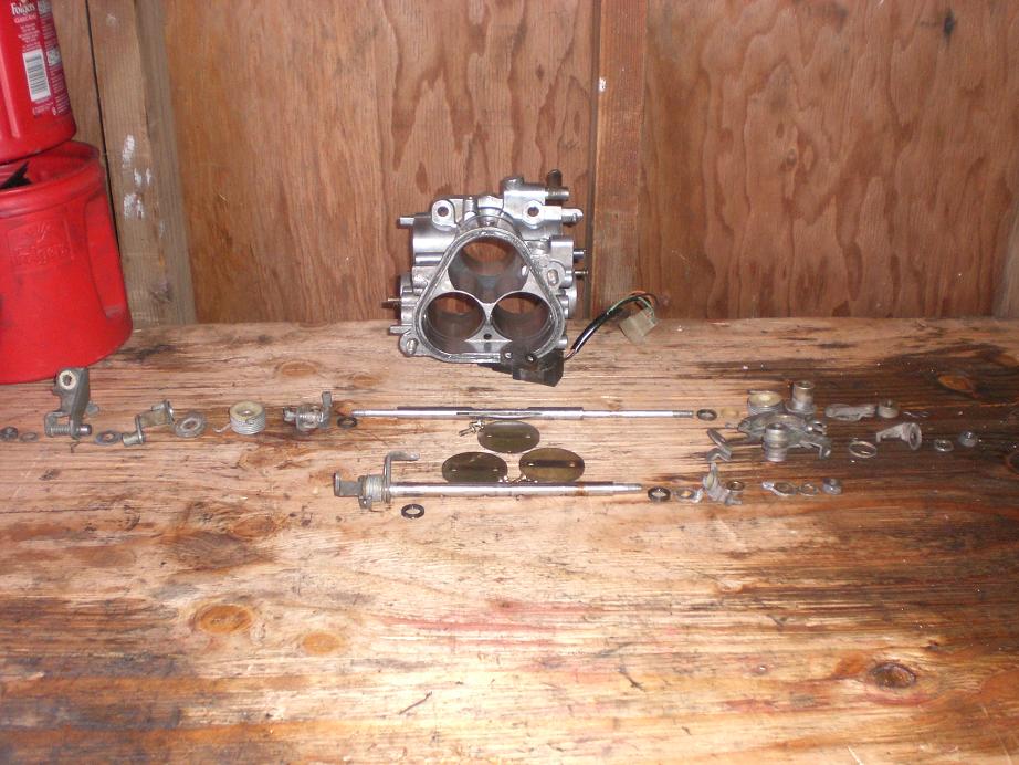

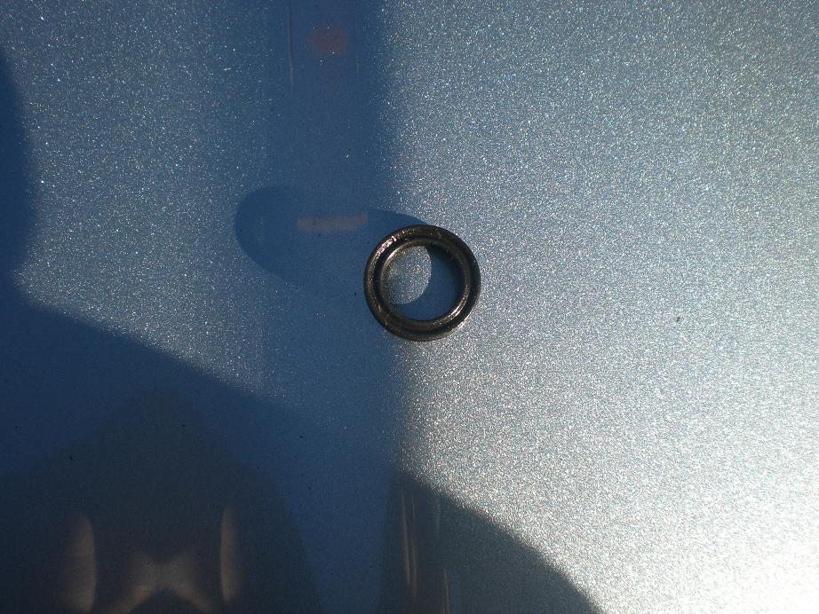

disasembled the throttle body today now i can take the seals and compare with others. im guessing a o ring wont work as it apears to be a double type seal inside and out.
has anyone replaced there seals before? if so what did you get away with?
anyone know the oem size of the seal ill have to messure the shat and inside bore.
mazda supplys nothing for the throttle body i priced a TB up for fun. price tag was $2400 haha werido's

get an unmodified used one. that is not a common failure, and if you value your sanity you won't play guessing games with aftermarket seals. it'll be easier to just get another one.

If there's a number on the seal, a bearing/seal supply house can probably fix you up.

theres no numbers on the seal

So the bronze bushing come out. That woulda made powder coating a little bit easier.

I forgot about the double seal. It would still be worth it to take it to a hydraulic shop. You never know. There are also seal companies that will make you any seal but at that point, the cost is probably higher then a good used throttle body.

How did you find out that there are seals in the TB? I've been playing with mine all weekend (cleaning one, rebuilding another) and I cant see any sign that the bearings even come out.
GL
Old Oct 25, 2009 | 11:59 PM
blwfly's Avatar
kiwi from downunder..
Posts: 3,423
From: springfield,oregon
i took it all apart.
there is no bearings just the double sided seals i used a tiny pick to get them out.. i cleaned it up and put it together in the end only 2 seals leaks and its very faintly pretty good inprovment from 4 leaking madley.but not good enough.
