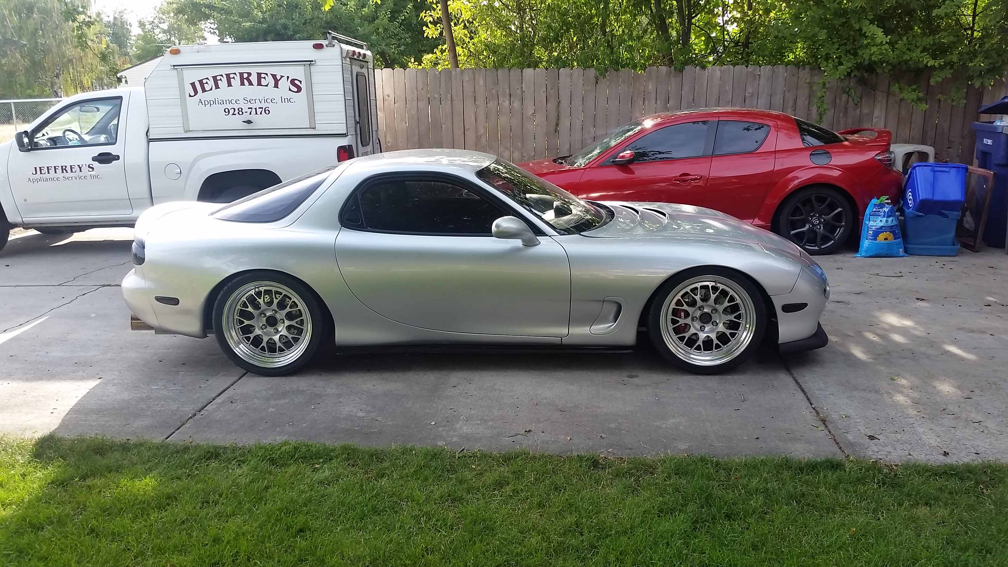

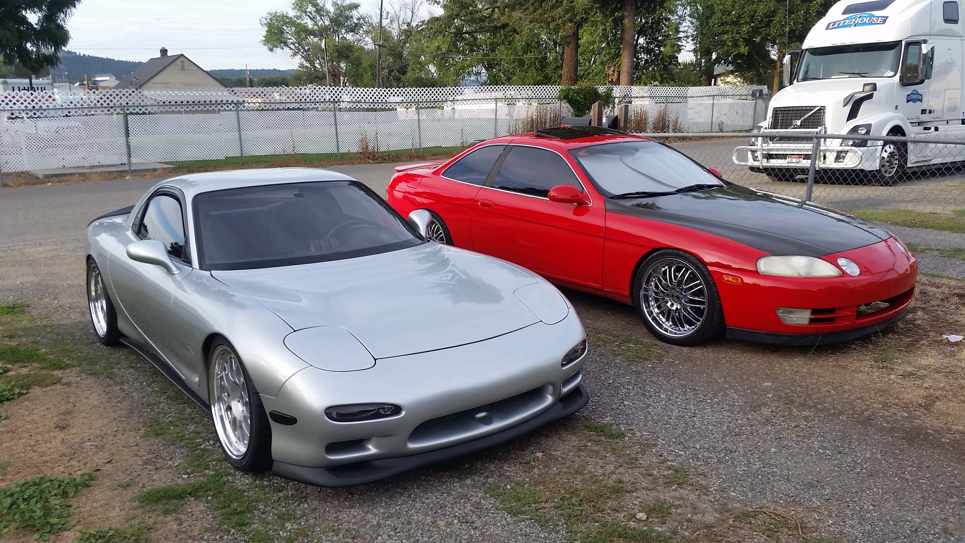

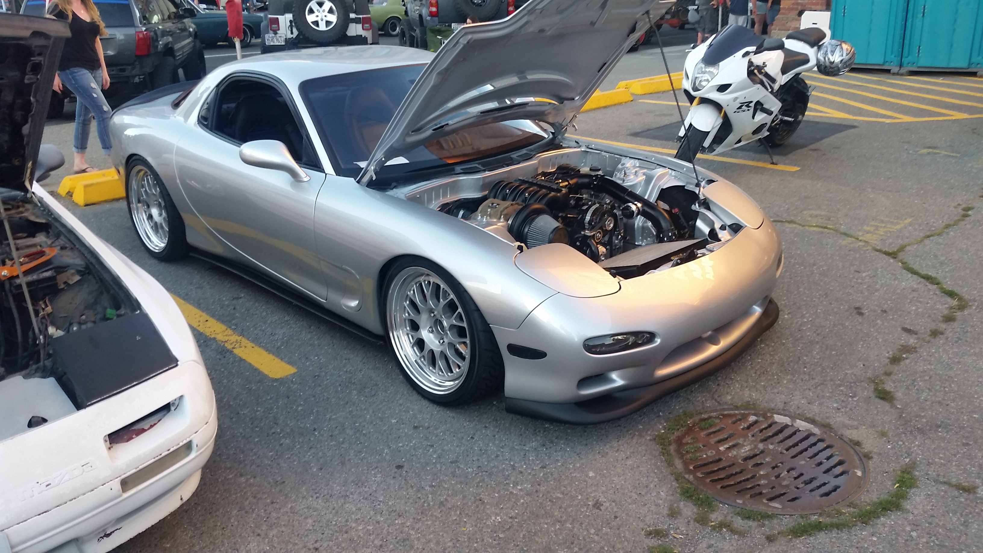

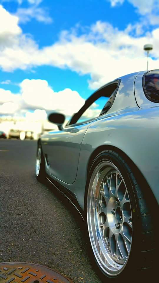

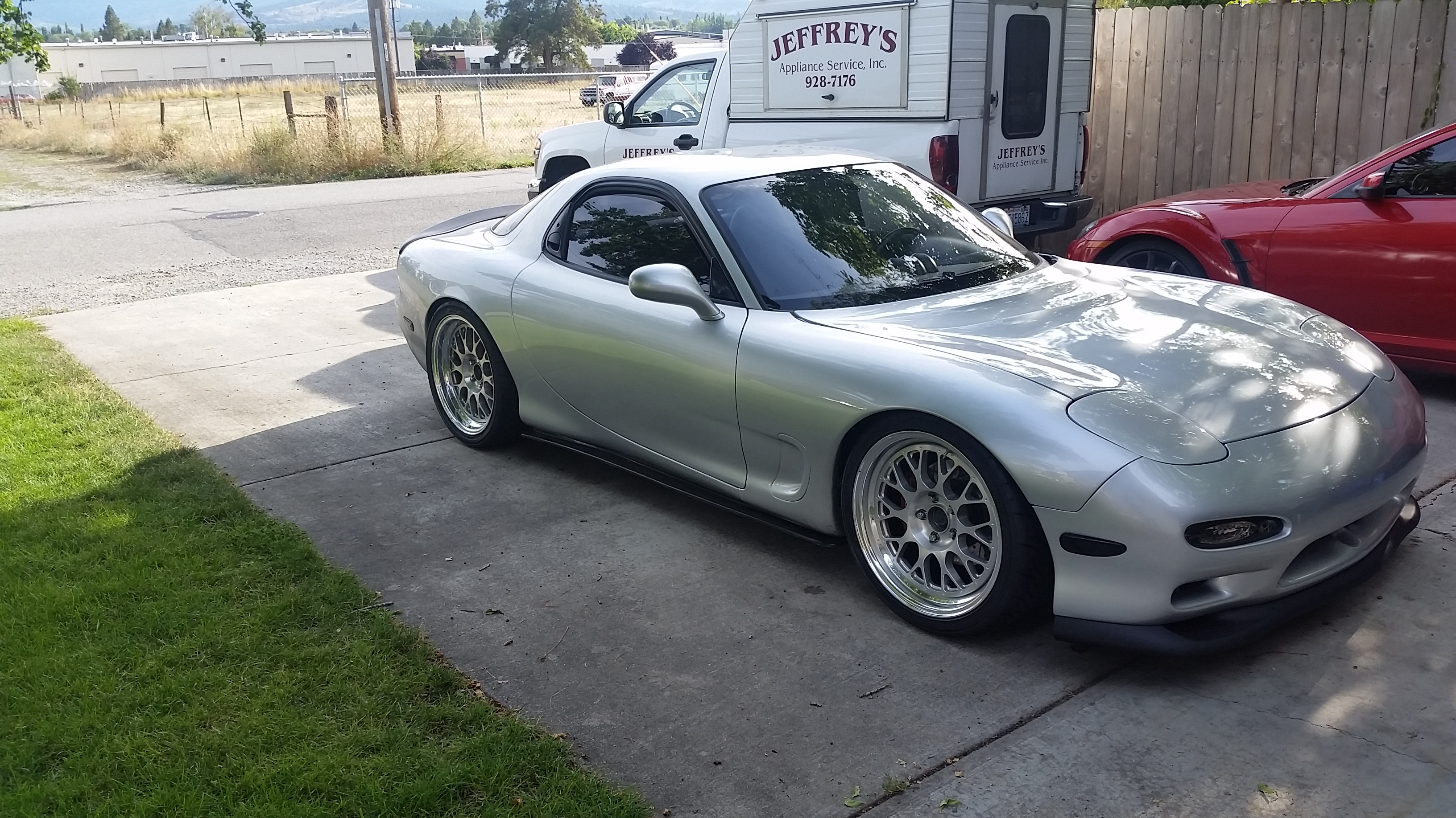

Fikse profile 10s satin silver polished lip. 18x9.5 +35 18x10.5 +33
255 35r18 295 30r18
Yokohama advan neova ad08r
Thanks to goodfellafd3s/rich farrell

Fitment looks on point👌🏻
Did you pulled the rear fenders?

Yes they are lightly pulled

Gorgeous... Love every thing about this

Thanks! This fd has come along ways!

Loos very clean , how many mm?

7mm

silverfdturbo6port, what radiator setup is that? Not sure I've seen one at that angle yet before.

Vmount radiator/intercooler setup.
Custom radiator
