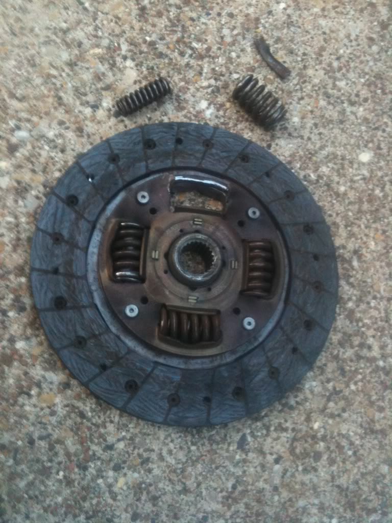

So after finally finishing tuning my car at 16psi (n/a transmission) I decided to go for a little drive. Ran into a guy with a 500hp civic, and ran the car for a bit. Suddenly after getting off the highway I pull the car out of 5th to down shift for the light. I wouldnt go into any gears. Manage to roll into a parking lot. Took the shifter out and put it back in. It went in gear and is driving fine again. So after 15 minutes of normal driving I get to a light at the entrance ramp to the highway. Floor it through 1st, 2nd, and 3rd. As I push the clutch to shift to 4th it felt like I could feel the engine/transmission move further away from the clutch pedal(dont know how to explain that one..). At this point it will not go into 4th or 5th. Some how I managed to jam it in. I drive for 15 mins and make it to a Jack n the box parking lot. It will not shift into any gear. If I have the clutch down to the floor it makes a loud screeching sound when trying to put it in gear. If I have the clutch 75% of the way down it still wont go into gear but it does make the loud noise. I checked the fluid and its full. Had a friend push the clutch pedal and I verified that the slave cylinder is moving the fork. I left Jack n the Box jamming it in every gear to get home and now here I am searching for what the issue could be. After checking google and on here a bit it leads me to believe the pressure plate is the issue. I just put this transmission on less than a month ago, so I'm really hoping I haven't killed it this quick.

Found the issue. Transmission should be safe!!!

That would cause an issue. And don't complain about pulling a trans at 3 in the morning. Me and a buddy pulled the trans, swapped and repainted a good-condition driveshaft, replaced every seal on the transmission, replaced the mounts (having to torch the bolts since they were so siezed in there), replace the pilot bearing and seal, replacing all the fluids, bullshit around, rescue a one eyed kitten that walked into his barn, and put it all back together and back in and driving again by seven in the morning. We started around seven the night before. I then worked a 10 hour shift the next day.
