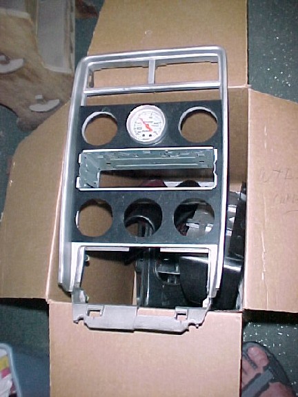

This is my Original, Unmolested dash - when she was a bone stock GSL-SE.

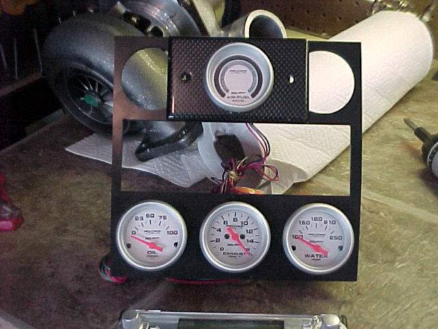

This is my OLD Dash - The Carbon Fiber style setup, with Silver Faced "Ultra-Lite" Autometer Gauges.
The "Ultra-Lite" gauges looked great, but were almost impossible to read at night. I do most of my FB driving at night, so I wanted something I could see better.
I then switched to Autometer "Cobalt" gauges, that are reverse indiglow style, with LED lighting. They look great at night.
You can even see a little "in-car video" of these guages at night, in my old
"First Gen kills 350Z Video" thread.
Attached Thumbnails Carbon Fiber Style Dash-mvc-276f.jpg   Carbon Fiber Style Dash-basic-template.jpg   Carbon Fiber Style Dash-basic-setup.jpg   Carbon Fiber Style Dash-bracket.jpg   Carbon Fiber Style Dash-mvc-271f.jpg

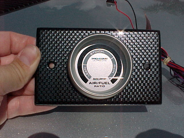

Now that we have that out of the way - On to the Carbon Fiber Style.
1st: My Dash is NOT REAL Carbon Fiber.
2nd: My Dash is NOT Carbon Fiber TAPE.
This is a black receptacle, used to cover any holes in walls for wiring not needed, etc. It has the CF style on it:
Pictures do NOT do it justice. It looks deep, and 3 dimensional. It has a Weave pattern which is extremely realistic
It is a process called Photolithographic or “water-transfer” printing. It is what car dealers use for “Wood” Trim as well. (By the way, this is EXACTLY how "fake" wood trim is done.)
The people who do it are usually work for car dealerships, and large yach companied. They do all kinds of CF look, and in Wood Trim for the large yachts.

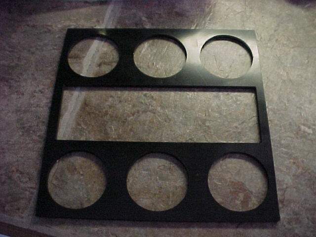

Once I figured out what I wanted, I went ahead and prepared a simple bracket out of regular plastic.
Then, after playing around to get it just right, I tested the gauges.
Then I glued the bracket/template onto my stock Center console, and it stayed there.
Then I had the process I described done by a local company, and I was done.
I have other pieces already done, like the door handle surrounds, the overhead light surrounds, the e-brake, power windows surrounds, etc.

You take your stock piece, and sand it smooth (like if it was to be painted). They do the "process" described above. They dip it in a water solution, with the [carbon fiber or wood] print floating on the top of the solution. As they push it down, the print transfers over to your piece, and becomes one with it.
It gets every nook and cranny this way, and keeps the same print throughout. When it's finished and dry - Then they clearcoat it with automotive grade clear. Then you are done.

what did you use to cut the holes in the plastic? how many inches?
