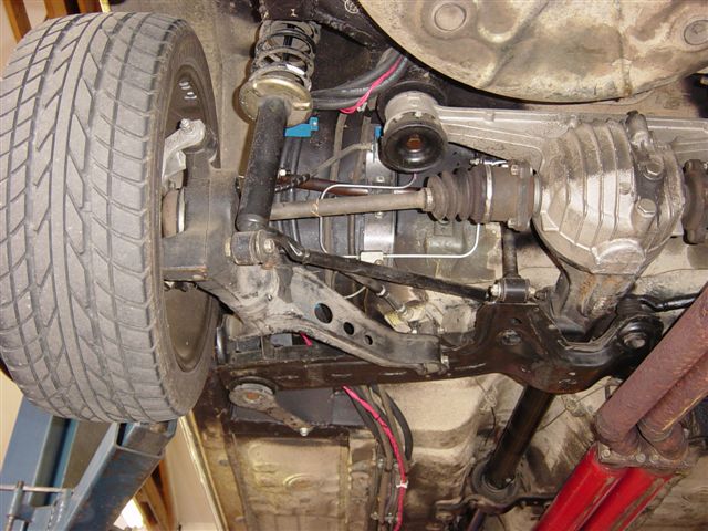

this is my RX4 and so fare the only thing I've done to hurt it was trying to do a@nd gear hole shoot and pulled the seface off of thr fly wheel and plate.I'm useing a real old OME disk
