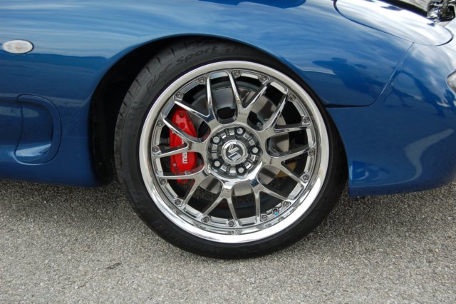

bump... any more pics of the car outside. Trying to see what these rims look like with the sun hitting them as well as how they look at night.
Beautiful car.

here is a good one from the Quad city BBQ here in Texas.
http://www.rotaryrendezvous.com/phot...s/DSC_0042.jpg
http://bdc.cyberosity.com/v/BDC/Quad..._3050.jpg.html
http://photobucket.com/albums/y258/2...t=DSC00768.jpg
http://www.myrotarycar.com/people/Qu.../photo104.html
Attached Thumbnails Volk SF Winning in RMC 18x9 18x10 pics/weights-photo104.jpg

if the pics don't work I posted the links below.
no nite shots yet.

I do like them I just wish they weighed less. I wish I could have the weight of the CCW one piece rims that just came out.
Regardless, when I swing by the shop and see them sitting on the car and the sunlight hitting them....they do look kinda cool

car looks good but you desperately need a front lip and an undertray

i like the rims.. ALOT!.. I have 19 inch C2's on mine.. and at times wish they were 18's... but I def have the pimp factor down with the big shoes..
anyways.. only thing i would personally change.. is raise the car.. 1/4-1/2 an inch.. make the wheel well more evenly spaced..

I have them remember? I have the CF 99 spec lip and 99 spec undertray. It's just going back for one more paint before I put it on.
its a LONG term project!

the car is already set at the 25 inch ride height according to what Howard Coleman recommends...
so its more for tracking less for looks. What looks off to you?
