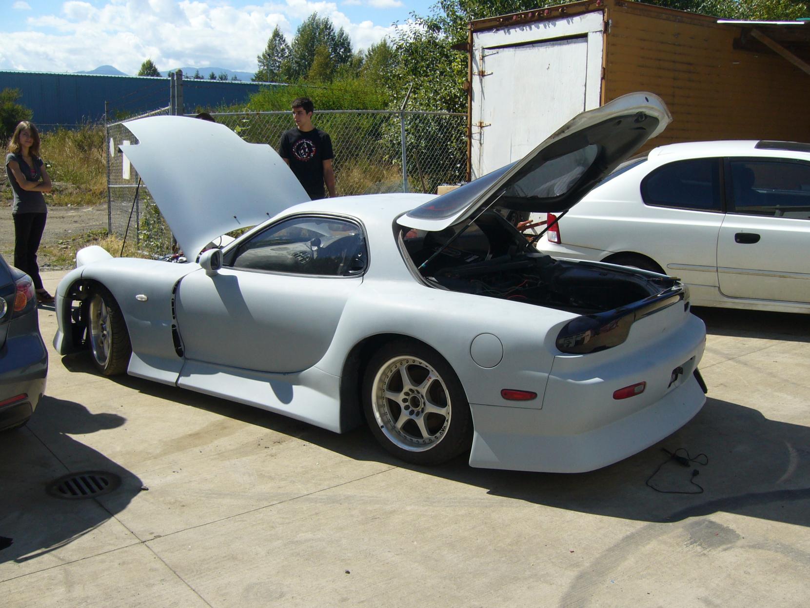

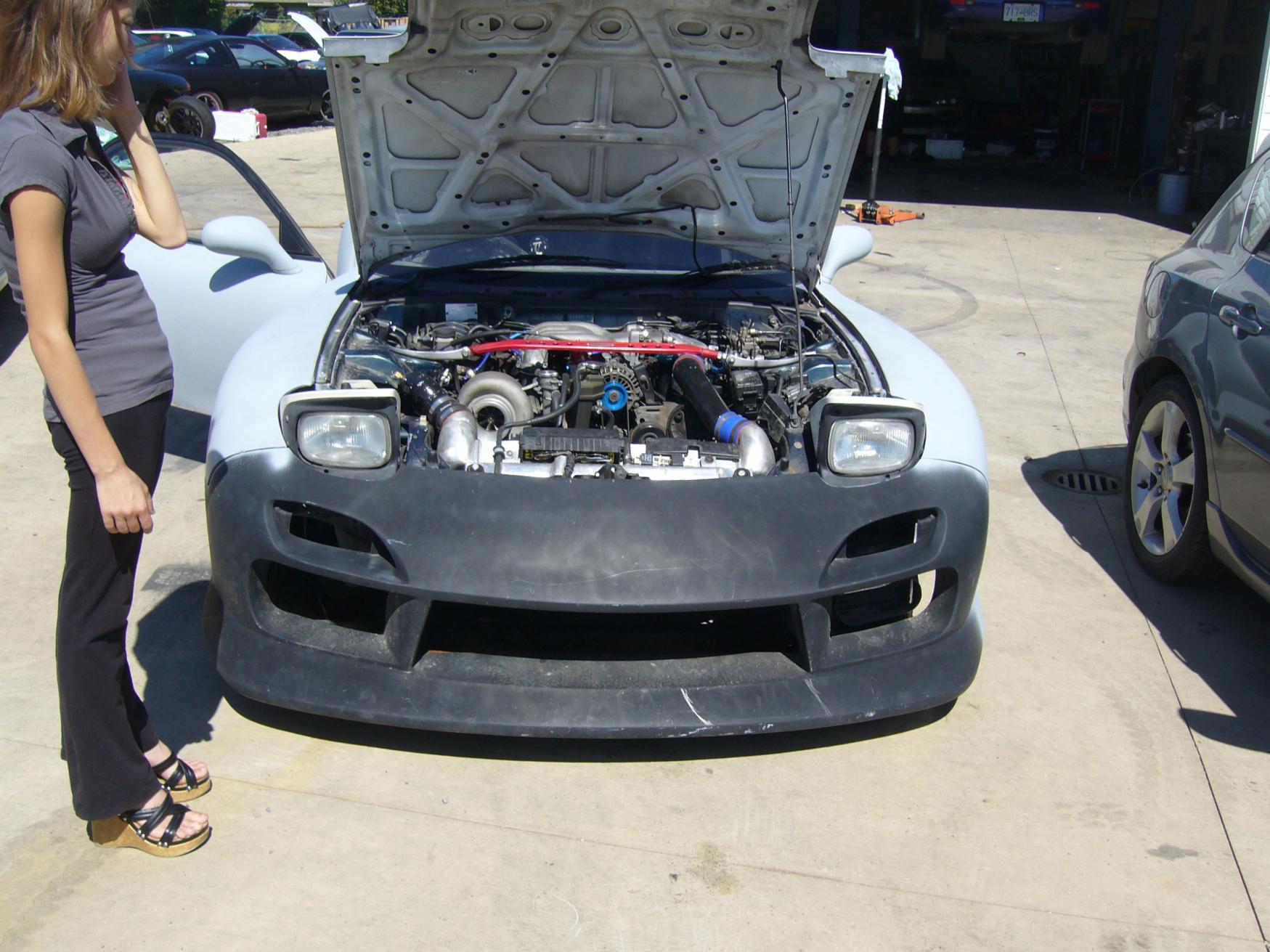

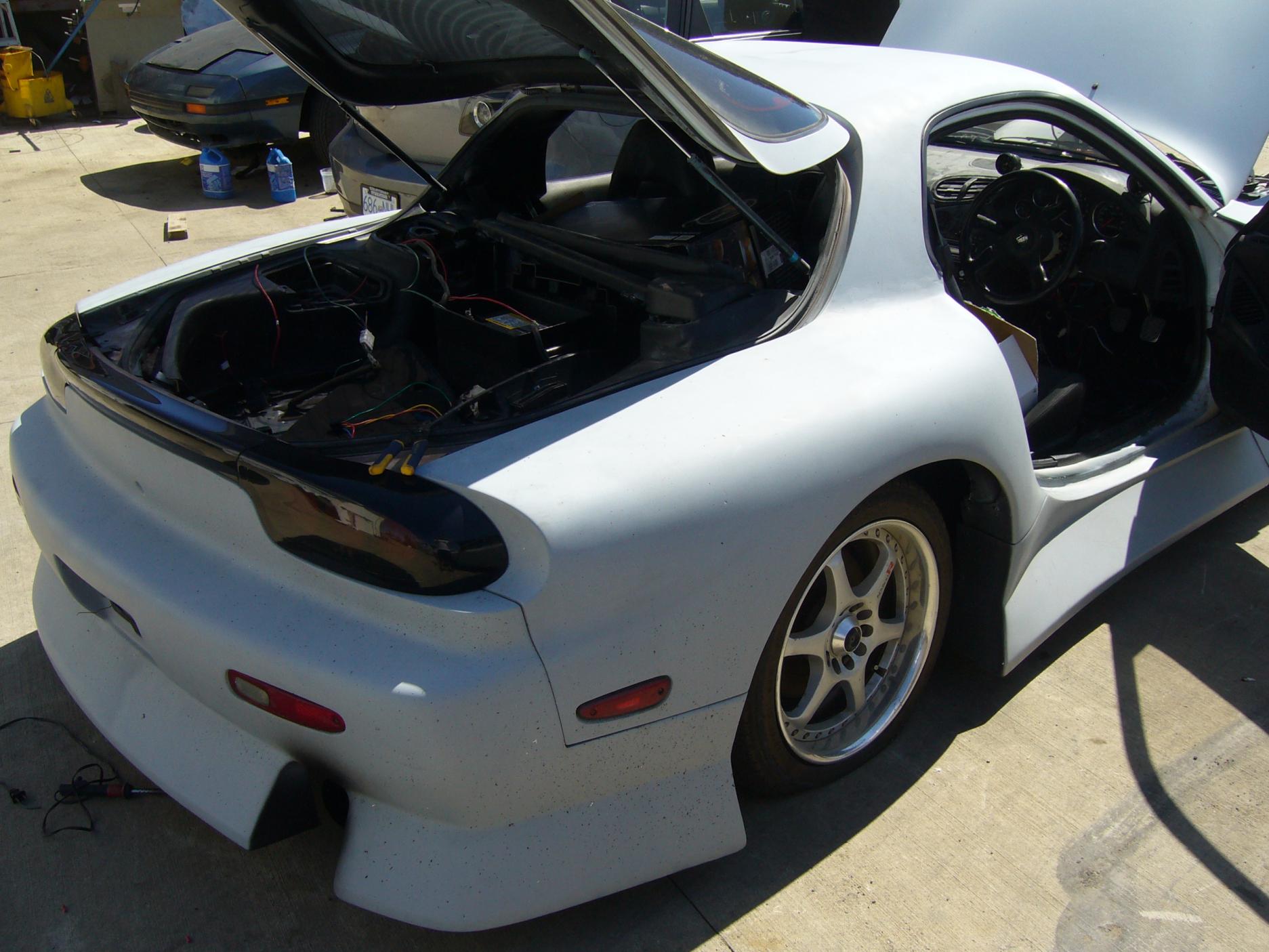

new picturess and video of it running .. almost ready for the road haha ! im stoked
Attached Thumbnails t88 widebody build!-img00034.jpg   t88 widebody build!-p1000389.jpg   t88 widebody build!-p1000386.jpg   t88 widebody build!-p1000390.jpg   t88 widebody build!-p1000392.jpg

No offense man but I thought the widebody in your car was way worse than his especially those fenders that yours came with...Now I'm not a fan of his body kit either I just don't find it as offensive

i unno with a set of nice wheels and maybe a spoiler maybe not.. and a paint job.. i think it will look great.. but thats my opinion...besides i put alot of hard work into it.. and well i think its great. definatley the best car ive driven

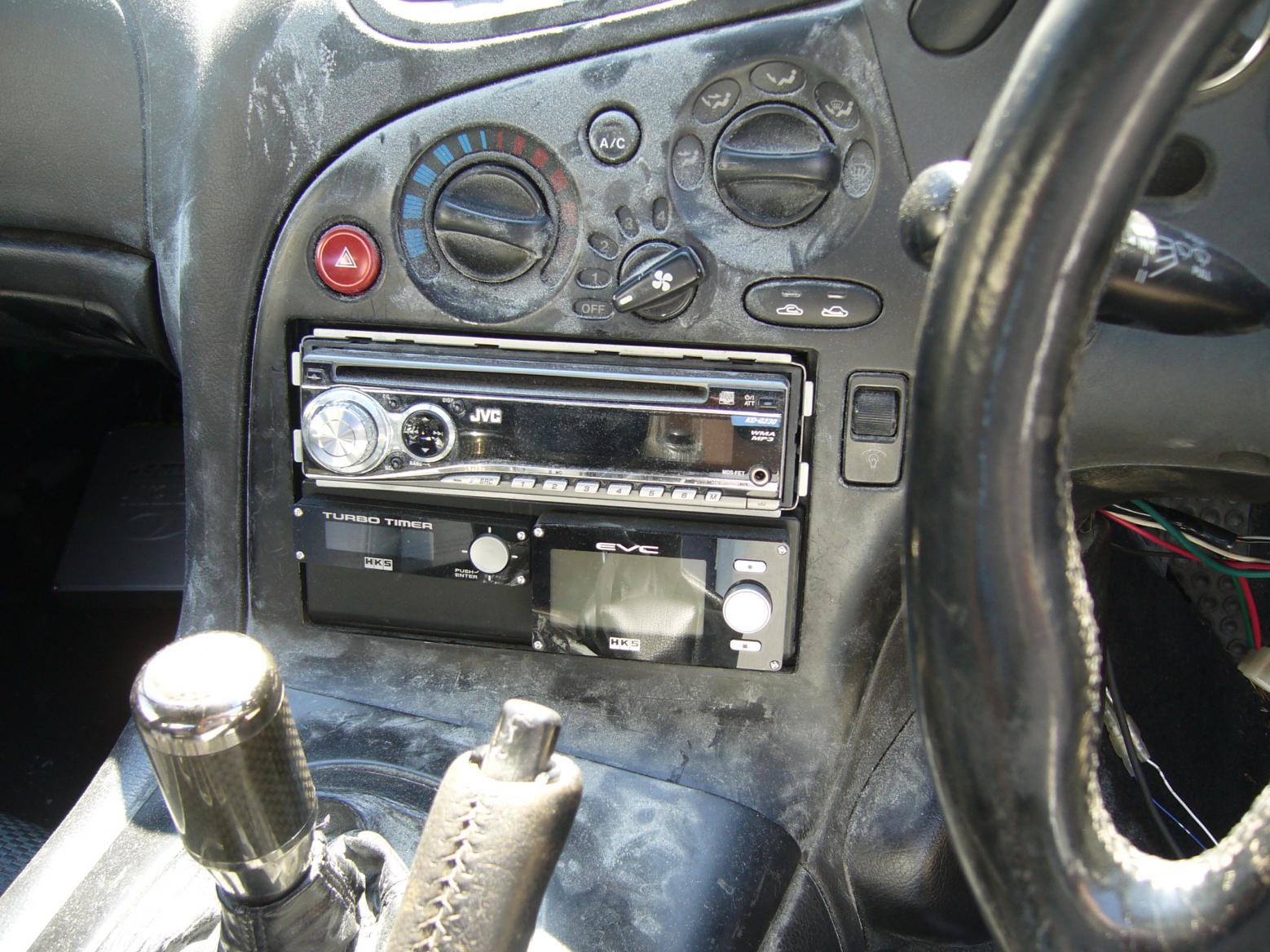

WTF is wrong with ur dash?
-Austin
Old Aug 13, 2010 | 06:50 AM
  #48
Posts: 30,814
Likes: 655
Somebody needs to tell that girl to eat a sammich.

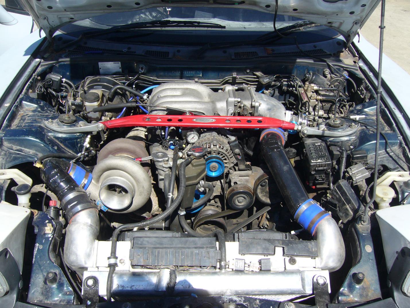

Edit: hate to be so critical, but here goes:
Consider cleaning your engine bay and interior before posting pictures. It's a shame to see it so dirty. Also toss that AST in the trash can, and find an air filter for your turbo.
Old Aug 13, 2010 | 08:12 AM
  #49
Ball joint's Avatar
Turbo Lover
Joined: Feb 2003
Posts: 783
From: Cleveland
Why is the intercooler behind that radiator?
Old Aug 13, 2010 | 08:22 AM
  #50
djseven's Avatar
Eh
iTrader: (56)
Posts: 6,554
Likes: 344
From: Nashville, TN
One of the first things that popped in my head. That is a horrible placement like that, horrible.
OP take all this as constructive criticism.
1. Delete the AST asap, you have the filler neck that makes it super simple. Call Ray at Malloy Mazda and tell him you have an fd and you need the AST delete kit, I think it is $45.00.
2. Get that intercooler in front of the radiator, mount it correctly. You are pulling extremely hot air thru the intercooler. You would rather have coolant temps be 3-4 degrees celcius higher than having your intake temps be 20 degrees celcius higher.
