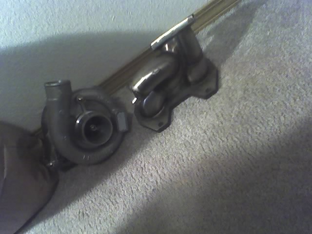

From: Olympia, WA
gt32 here with speedmachine's manifold
Old May 2, 2007 | 01:20 AM
marcus219's Avatar
FC Mobsta
Posts: 1,825
From: Olympia, WA
pic
Old May 2, 2007 | 01:28 AM
RETed's Avatar
Posts: 26,664
Likes: 23
From: n
Too small.
You'll need two of them on a 13B.
-Ted
