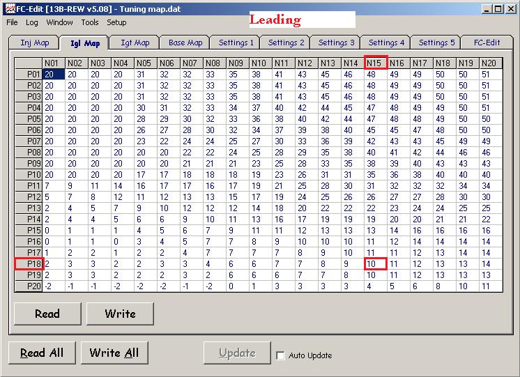

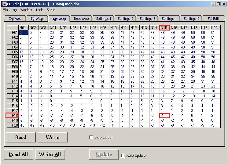

Split = Leading timing advance (degrees BTDC) - trailing timing advance (degrees BTDC), even if there are negative numbers in the map.
Negative split only exists in cells where the trailing timing number is quantitatively bigger than the leading, meaning that the trailing plugs are firing more degrees of crankshaft rotation before the trailing. A higher number means you are firing the plugs sooner. It's kind of annoying to do this calculation though, so that's why people have their EMS or a spreadsheet calculate it.
Now let's do a sample calculation.
So start with your P18 row. Assuming this is a stock MAP sensor and calibration, plus default scaling, that's probably a little over 15psi or so. By default P18 is 20000 PIM:
20000 PIM = atmospheric pressure + 1.0 kg/cm^2 boost = 14.22 psi boost. Plus let's add about 1 to 1.5psi because the stock map sensor scaling is off some. So we're at anywhere from 14 to 15.5 psi maybe.
Now let's jump to P18 (a little less than 16psi), N15 (6000rpm). First take our leading value:
The leading plug is firing 10 degrees before top dead center.
But the trailing plug is firing -1 degrees before top dead center. Any negative value actually indicates that the plug is firing after top dead center. 10 - (-1) = 11 degrees split at 6000rpm near full boost.
Correct. Whoever looked at that map may have assumed he was reading a split map. That's an honest mistake. I presume that whoever tuned this originally emailed you these maps?
So the question is, is that timing map safe? Well that all depends. We don't even know the scaling of the map, I just assumed it was default. We also don't know the AFR or the fuel quality (91? 93? methanol injection or mixing a little race gas in there?). Would I run that on my own personal vehicle with 91 octane, half bridge, and the 9:1 compression FD rotors? No, and that's mostly because I think there isn't enough safety built into it for aggressive porting. On straight pump fuel at 14+ psi I prefer 15 degrees of split for motors with heavier porting, if only for peace of mind.

And yes it is better with the Split checked
I am sorry I am new at using the FC-Edit.

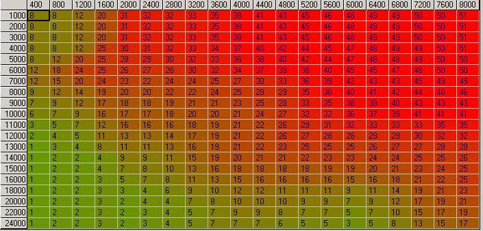

Here is the picture:
The negative cells seem to be early on the timing? If I am seeing it correctly?
Also I am posting here the other parts of the tuning to help:

The negative split is not causing a problem in those areas. Remember that Rx-8's run negative split from the factory under some low load conditions.
the split under boost... well it's not conservative. But could it have blown your motor? That's hard to say as just an internet diagnosis. There are so many other factors. The leading map doesn't look dangerous though. It seems like whoever tuned it put a leading map in there and either didn't know enough or didn't care enough to adjust the trailing ignition properly.
Your asking if the map could have blown your engine. I don't think anyone could tell you this with certainty. I can say that there wasn't much time put into that timing map. The leading timing is pretty safe at high boost but at lower boost its aggressive I believe. I think the aggressive lower boost leading timing and the aggressive split might make for an unsafe timing map but there are other factors like fuel ratio that could make the overall map safe. In my opinion that is a bad timing map, if I were you I would get someone else to tune your car like Steve Kan.

this engine is a bridgeport correct? and your running pump fuel?
If both are true your tuneup is way to aggressive for me. split is too aggressive and all over the place, lead timing is wrong for your type of engine and fuel, im going to guess that's it's too lean too...
Can this cause your broken apex seals. Absolutely. Stock mazda apex seals will always break when you rattle/detonate a motor. There's no second chances..
Seems like your tuner just used a basemap from the internet and made small changes to it..
I would highly recommend bringing your car to an experienced tuner.
I really don't see any glaring problem with the leading map. It's running at most 11 or 12 degrees up to maybe 6000rpm, at any level of boost much over 10psi or so.
What really stuck out to me were the default injector transition settings in settings 5. Didn't the car stumble or have a lean spot getting into boost? How do we know the staging wasn't so bad that it detonated during transition? Those default settings are for 850cc secondaries!

11 psi? that puts you probably at the P16 row with that scaling. and your split is 7-8 degrees there. 7-8 split is pretty aggressive for a half bridge even on 93... but that doesn't guarantee a blown motor.
Do you have a wideband in the car? Did you notice it having a lean spot or hesitation that could be due to injector staging?
You'll probably find your motor blew because of you injector seetings under settings 3 tab.
Looks like you would of run lean. Has the map been played with since it was tuned? if not it was only chance why it didn't pop when being tuned.

Now for BNA ELLIS, the car has not been tuned after I picked it up. I drove it for less than 2 weeks and I was babying it just to make sure it was ok before I did anything crazy.
So yes, it was only chance that it didnt pop during the tuning session.
Now, the first time it DID pop during the tuning, but the installers said there was nothing wrong in the car and the builder said that it looked like a foreign object hit the apex seal because of the marks that it left inside.
Now I dont know anymore, it could have been just the tuning again

Honestly, I really do think tuning is the cause of your engine problem but that is only my opinion.
