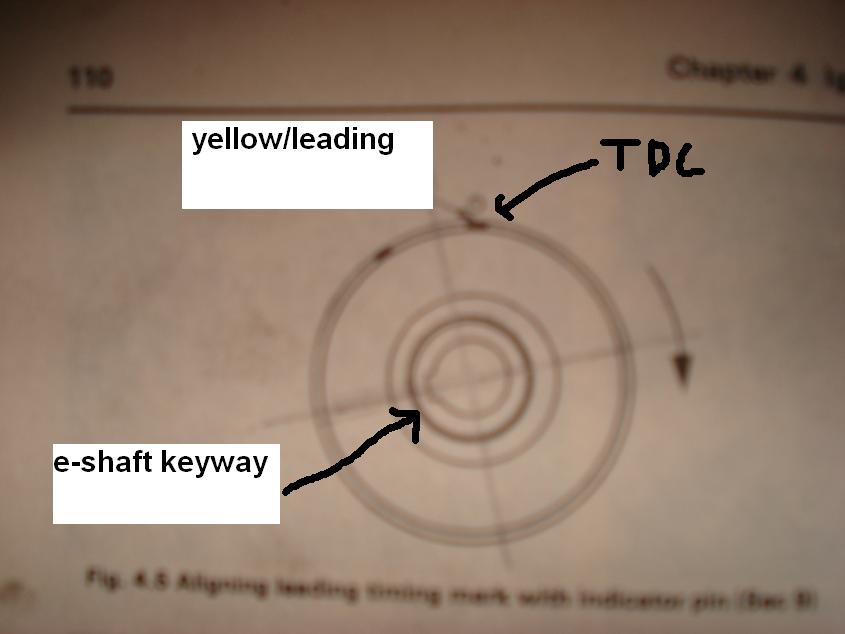

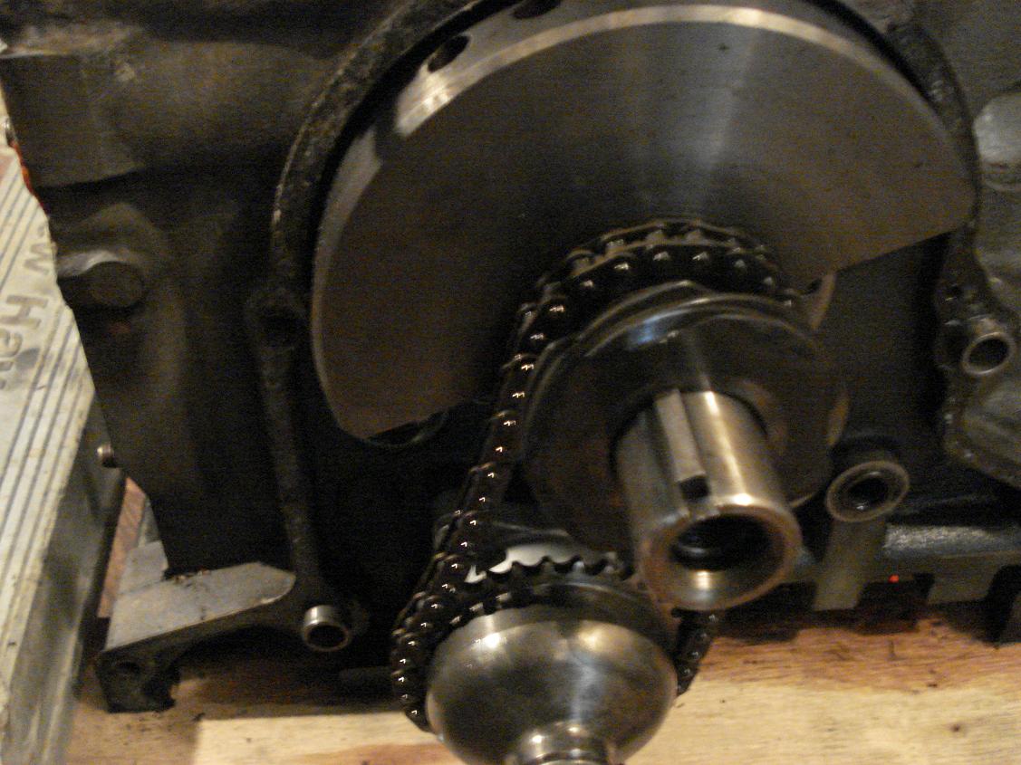

This contradicts wackyracers archived post though as you can see in the post i have 10awg wire in the rear leading spark plug hole on my SE motor (just a spare) and the notch on the flywheel doesnt line up the the inspection plate on the exhaust side. and the e-shaft keyway contradicts haynes orientation for TDC of leading??

The keyway should be pointing towards the exhasust manifold. I would of thought the wire trick would be used with L1, not L2?

Right i under stand this thats why i took the picture on top of the bell housing to show that the notch is at the top not at the exhaust side. This is with a wire (10awg) in the rear leading plug hole.

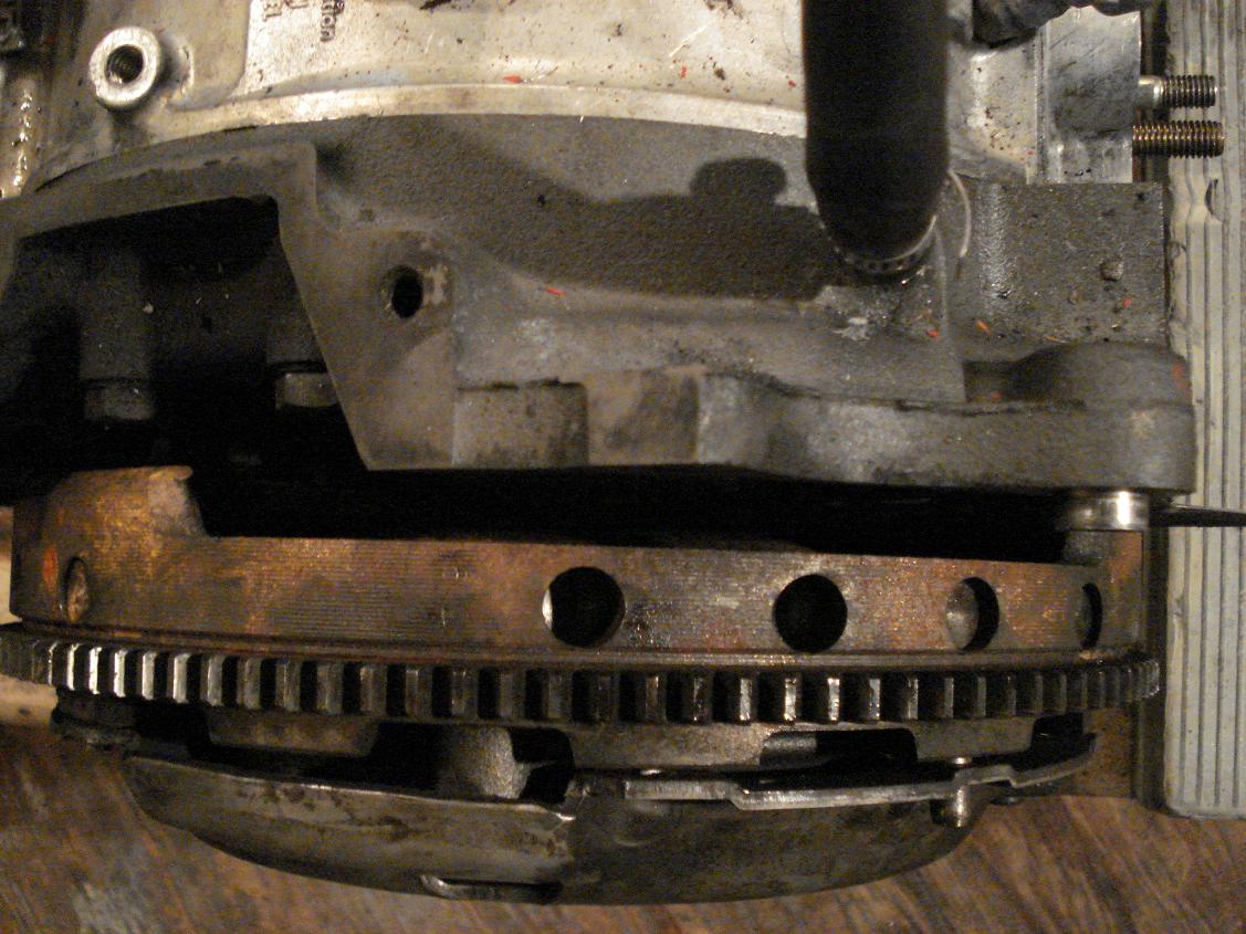

Sorry about the confusion but people have different methods in finding TDC. To elimnate the confusion, I will refer you to the "flywheel" method.
1. Remove the inspeciton plate located on the passenger side engine where the engine and tranny meets.
2. Rotate the e-shaft using a 19mm socket in the front pulley.
3. Using the flywheel, line up the flat side of the flywheel (back) with the engine block.
Pix A: S5 flywheel but all stock flywheels has a flat side.

4. Once step #3 is done, look at your front pulley. The notch should be at the pointer.
