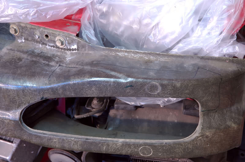

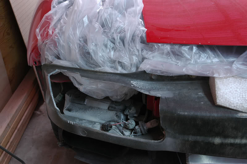

I wasn't able to find any thread about rebar modification, so I thought I'd snap a few pictures of my own and post them. All you need is an angle grinder, a cutting wheel, dust mask (you don't want to breathe that fiberglass dust...it gets EVERYWHERE), eye protection, and plastic to reduce the amount of dust that gets into your engine bay. It's no science...just test mount the bumper....mark off where the bumper touches and how deep the cuts need to be so it won't touch. Test fit again...check for bumper contact....trim....test fit again.
Unmodified
PS Unmodified
PS Modified
DS Unmodified
DS Modified
Bumper is off at paint right now. Will post new photos when complete.
Have fun!
