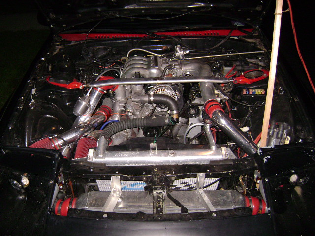

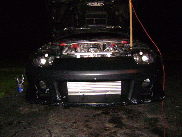

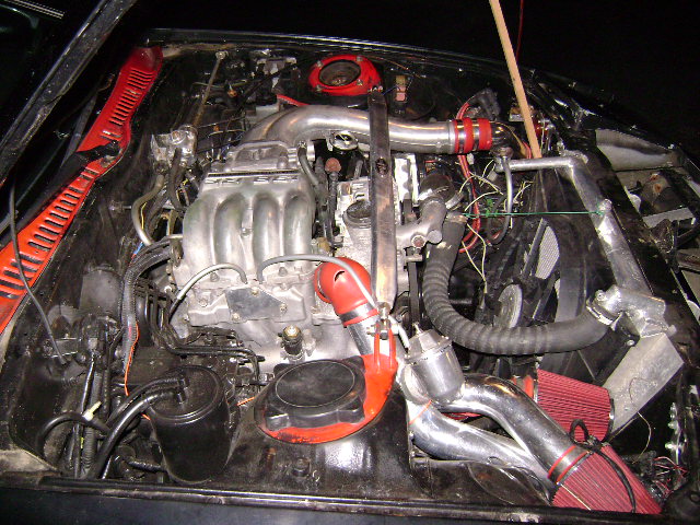

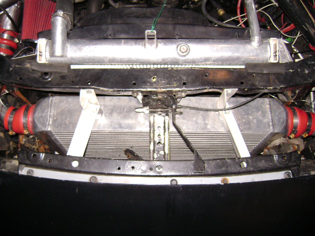

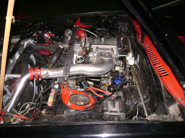

Old Sep 15, 2007 | 09:41 PM
2Lucky2tha7's Avatar
Back at it again!!
Joined: Jun 2003
Posts: 1,324
From: Western Colorado
Smile
10 years later........
Attached Thumbnails Status of my friend's Black '91 FC with a ported Cosmo 13B-RE-pictures-downloaded-jons-camera-076.jpg   Status of my friend's Black '91 FC with a ported Cosmo 13B-RE-pictures-downloaded-jons-camera-077.jpg   Status of my friend's Black '91 FC with a ported Cosmo 13B-RE-pictures-downloaded-jons-camera-079.jpg   Status of my friend's Black '91 FC with a ported Cosmo 13B-RE-pictures-downloaded-jons-camera-080.jpg   Status of my friend's Black '91 FC with a ported Cosmo 13B-RE-pictures-downloaded-jons-camera-081.jpg

yeah, it's been done that whole time, and he brought it over here 2 days ago with his camera as well, and then I remembered that I had a thread about his car from a long time ago. As you can see in the pics, the red elbow coupler on the passenger side next to the strut burst as well as him wanting aftermarket fenders, manual windows, and a bunch of other random stuff done. He needed his camera back that night, so I took a few pics, saved em, and gave it back.
