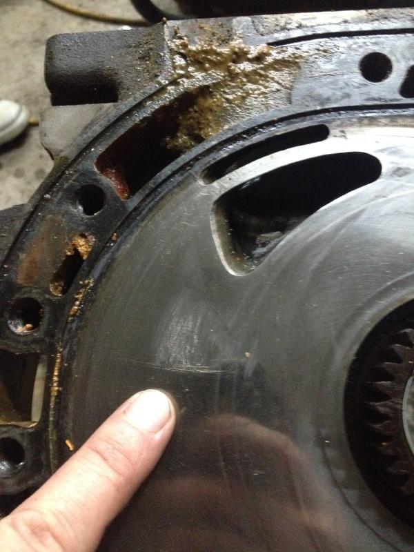

After teardown of the engine here is what we found:
^^^ Rough spot in the front iron behind the water pump.

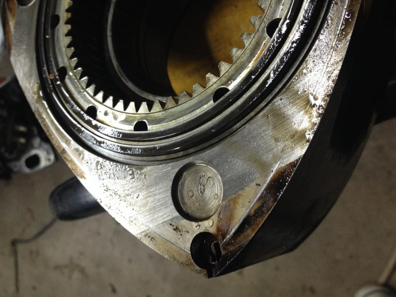

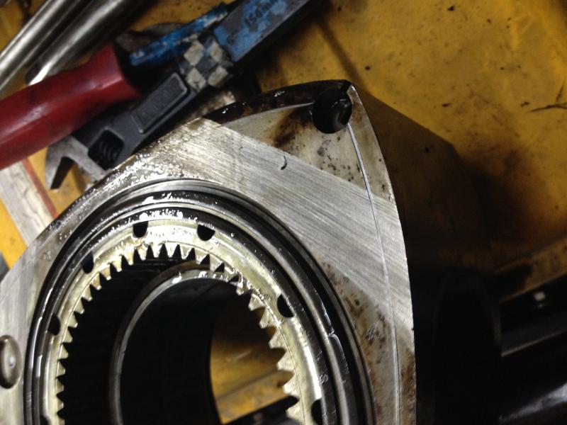

Side seals chewed off. One apex seal was jammed in the groove and bent.

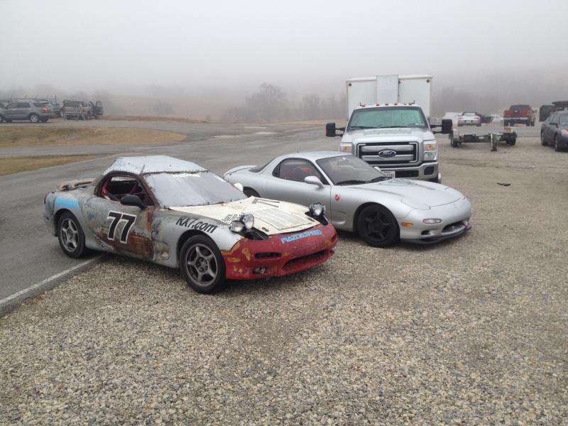

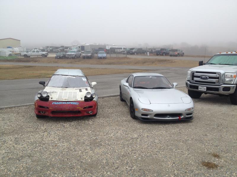

Check it out Tabasco. Parked our race car next to some piece of **** we found at the track!!!
