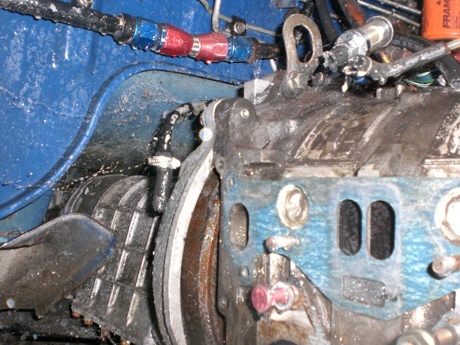

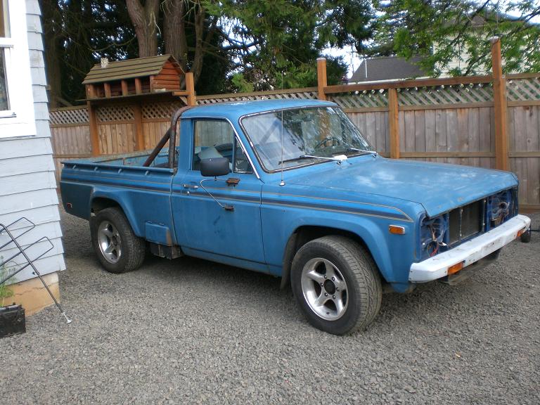

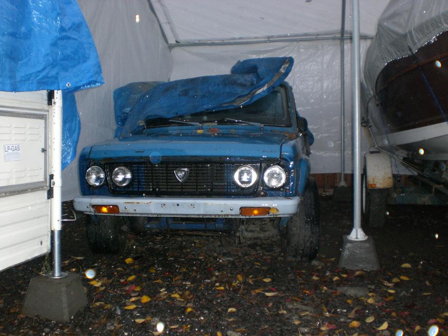

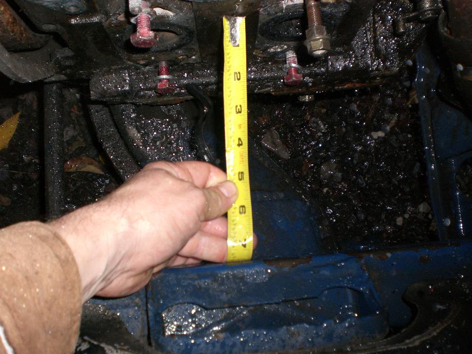

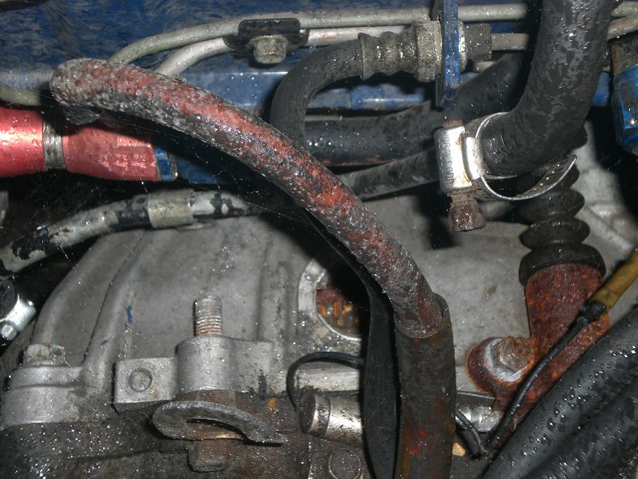

heres some pics my friend has brought to my attention i have ford courier
hood and maybe bumper that sucks lol.was pouring down with rain pics are a lil dark
looks like i might have 1/2" clearence with the stock t2 waistgate to the frame.
just from the pics do you think this is a 74 repu tranny i felt around and it has 5gears.
Attached Thumbnails who has or knows of installing a TII engine in a repu-cimg1173.jpg   who has or knows of installing a TII engine in a repu-cimg1174.jpg   who has or knows of installing a TII engine in a repu-cimg1179.jpg   who has or knows of installing a TII engine in a repu-cimg1186.jpg   who has or knows of installing a TII engine in a repu-cimg1190.jpg
