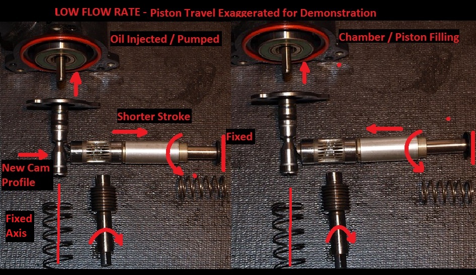

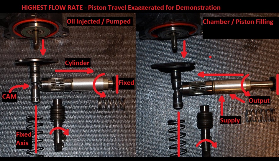

Crap I put this in the wrong OMP Declassified thread, had all three open in tabs and picked the wrong one - this being about the Mikuni and not Denso. If a mod sees this can you please relocate if possible as I cannot delete the post.
Working on restoring my FD and wanted to see the condition of my OMP, plus I wanted to see for myself how it worked. The info in the three OMP Declassified threads was awesome, and though I might be able to add.
I am fairly certain I have the following two pictures correctly demonstrating how the OMP uses the rotation from the e-shaft and a cam profile to pump/meter the oil. The operation of the OMP's pumping action is similar to one piston in an axial piston pump.
High flow rate. This is when the servo motor forces the flow rate control shaft downward. This allows the longest travel of the piston, increasing cylinder displacement and increasing the pumps output.
Low flow rate. This is when the servo motor allows the flow rate control shaft to rise. This reduces the travel of the piston, decreasing cylinder displacement and decreasing the pumps output.
Few assumptions:
-even if the servo motor dies, the OMP should still function. However, I would assume the cam profile would remain on the setting when the servo died. Either injecting to much or too little oil depending on RPM.
-To increase ouput, bore out cylinder sleeve, and replace the piston with a matching increased diameter piston. Or, alter the profile of the flow control rate shaft.
Please let me know if any of my statements or assumptions are incorrect so I don't mislead anyone. I just though having pictures might make the OMP's pumping action easier to understand.

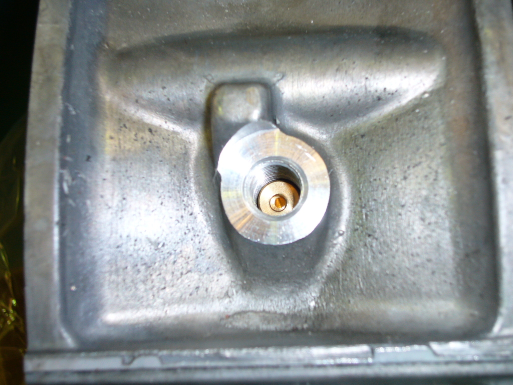

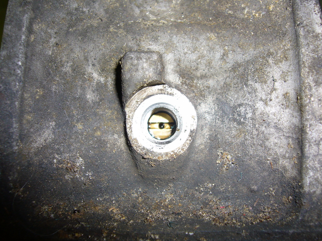

Probably depend if the jet size changed - a set of .1mm increment drills probably required to test that on old and new housings. Here's a couple of pics I'd forgotten I'd taken from years back comparing them...
doesn't seem to be a huge difference to the eye at least!

Thank you for the pictures, they say 1000 words!
I can't see a point of using the grommets on the older jets when there is a ridge all the way across. They will not seal anything like the newer jets. At this point I am debating just using the old larger injectors with the newer mikuni pump for more oil to flow into the housings.

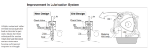

I've looked around for a cross sectional image of injector nozzle because I realized I don't actually know what type of check valve is in there or have any idea what it looks like inside. I've never found any specific literature on this but I did find this image.
This is from a 1999 Mazda press report, it seems to show that the only difference in the nozzle design is the inner diameter and the addition of the seal. Check valve and design appear to be the same (assuming the drawing is accurately representing that part).
Does anyone recognize the type of check valve depicted?
