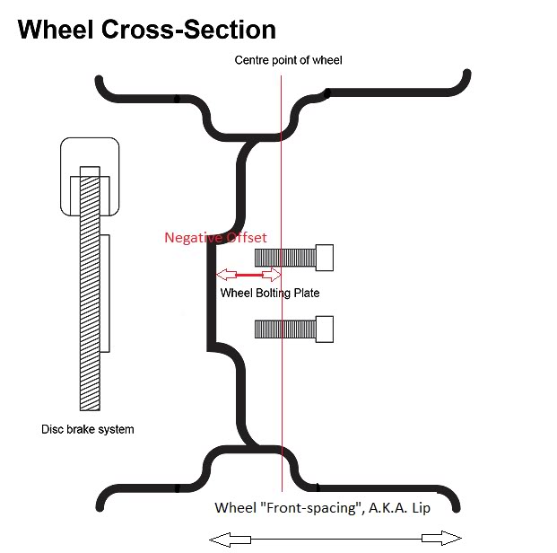

This will be based on simple mathematical formulas to determine from wheel size and offset, what the resulting "Back-spacing" (Distance from hub to inner lip of wheel) and "Front-Spacing" (Distance from hub to outer lip of wheel) are. The significance of knowing these two measurements in reference to the FC's wheel hub is that the "Back-Spacing" determines suspension clearance from the wheel/tire, while "Front-Spacing" determines clearance to fenders. Note now, these measurements will be impacted heavily by tire choice, if you go with a tire much wider than the wheel, you will have to compensate. It will generally not be the wheel that will contact parts of the car, it will be the tire, so that is why this is simply a guide. I know some idiot is going to come on here all up in my **** saying that his 12" wheel fits stock fenders fine at -30 offset and 8* negative camber with a 225 tire stretched on it. Straight up, go **** yourself.
Now that that's out of the way, let's look at HOW to obtain the physical measurements of a wheel from its width and offset!
To determine back-spacing, we take the width of the wheel divided in half to obtain the centerline, then add the offset (or subtract it in the case of negative offset)
Let's take the stock FC TII wheels, 17 x 7 +40mm offset. Mathematically, we take 7"/ 2 = 3.5", multiplying by 25.4 to get mm's gives us 88.9mm (half-point, or centerline) and add 40mm stock FC offset, and we get 128.9mm back-spacing, or 5.07"
To determine Front-spacing (I don't know if this is an actual term, but it is the distance between the hub and the outer lip of the wheel) we divide the width of the wheel in half again to obtain the centerline, and subtract the offset (or add it in the case of negative offset)
Again, let's take the stock FC TII wheels, 17 x 7 +40mm offset. Mathematically, we take 7"/ 2 = 3.5", multiply by 25.4 to get mm's gives us 88.9mm (half-point, or centerline) and subtract 40mm stock positive FC offset to get 48.9mm, or 1.93” “Front-Spacing”, or distance between hub and outer wheel lip.
To verify our calculations, simply add the calculated Back-Spacing and Front-spacing, 5.07” + 1.93” = 7” total wheel width.

To add a common question and answer to what Trots*88TII-AE* already posted up here;
Front over Fender +30mm would look like this;
Inner clearance = 140mm
Outer clearance = 120mm (90mm OE + 30mm Aftermarket Fender)
Total = 260mm Which is a 10" (254mm) Wheel width
Centreline of the 10" (254mm) Wheel is 127mm
Inner Clearance - Centreline = 140-127 = +13mm offset
So ideally for many reasons the ideal wheel Tyre Setup (tyre width matches rim width) with a car with OE rear fenders and front +30 aftermarket fenders would be (knowing that these would be custom wheels as it would be tough to find these offsets);
FRT = 18x10 +13 Wheels with 255/35R18 Tyres
RR = 18x10.5+23 Wheels with 265/30R18 Tyres
