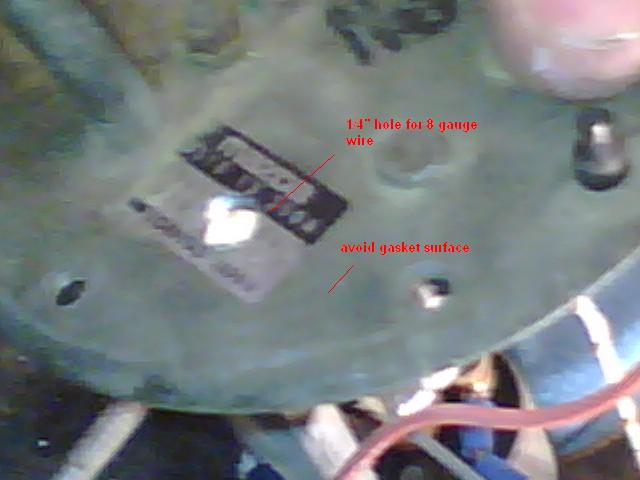

Alright so I decided I wanted to rewire my fuel pump on my 88 T2. The previous owner had rewired it to relocate the fuel pump resistor relay, as most people do. Well the car has been leaning out despite having more than enough injectors and fuel pump. I had tried testing voltage before and I was getting some low numbers for whatever reason (bad resistor relay? high resistance connections? who knows). So I figured I was just going to go all-out on my rewire and cut out the resistor relay altogether.
I also decided I didn't want any of the original wiring to go to the pump at all (Except the fuel level sender wires). Corroded 16 gauge (14 gauge?) wire just isn't going to do it for a potential 400rwhp car. I have a Supra TT pump and I want it to flow as much current as possible without heating up. I may run a Kenne Belle Boost-a-Pump sometime in the future, which is pretty tough on pumps, so that's another reason I need good current flow.
So, starting from a writeup like this: http://www.1300cc.com/howto/how2/rewire.htm
I modified this diagram a little:
essentially became (excuse the crappy pic)
pretty much bypassed the stock resistor relay and made it similar to a nonturbo series 4 car, but I'm pretty sure you need to have those 4 wires jumpered together on the resistor relay harness for this to work right. Now, I'm not sure how many people actually run new wires all the way into the gas tank. I think a lot of people just run a new wire and then solder it into the stock connection at the top of the fuel pump assembly. I have never seen any specific info on running the wires all the way into the tank, so , so myself and a good friend took on the task.
The tricky thing is getting those wires in there without leaking fumes.
after looking at the fuel pump assembly for a little bit, there is really only one area where you can drill a hole that won't interfere with the original wiring or the gasket mating surface. That's near the mazda logo part. So we drilled two 1/4" holes (yeah that one in the pic isn't pretty. we cleaned it up after that). That was the perfect size for the Phoenix Gold 8 gauge wire we used. The fitment was tight and it barely slid through the holes, which means a small chance of any fumes escaping.
We had to go to autozone and look around for a while to find the correct ring and spade terminals that would fit the wire properly and connect onto the pump and relay correctly. You don't want to buy the wrong terminals and then hack up the wire to make everything fit. That defeats the purpose. Also, note that my Denso Supra TT pump connects differently than a Walbro I think. I think the Walbro has one electrical connector while the Supra pump has two separate terminals for power and ground that need spade connectors.
So we put silicone sealant where the wires ran into the tank, then put those wires through the grommet and ran them to where they needed to go. The ground wire went to a bolt hole back there that was very thoroughly cleaned with a wire brush attachment on a drill. The positive wire went to the relay, which should go like this:

Looks good...
However, 8 gauge is massive overkill to the extreme amount. 8 gauge is more suited to connect the alternator output to the electrical system.
12 gauge is more then sufficient for any reasonable fuel pump.
Also, don't expect that little dab of silicon sealant to last very long. Fuel will turn it into a strange jelly like substance and it will droop into the tank.
Fuel will also eventually wick up the wire.
In addition, the yellow plastic covers on the ring terminals will dissolve in fuel, as will the wire insulation eventually as this wire is not rated for in tank use.

First of all, gasoline is going to eat through your silicone seal and the wire insulation of that Phoenix Gold cable.
That makes for a very dangerous situation!
You need to find wire that uses insulation that is made to resist gasoline (Teflon?).
Second, when you're passing wires though metal like that, use this thing called a "bulkhead connector".
It's basically a big stud with two nuts on each end.
This is the proper way of running an electrical connection through a wall.
-Ted

As mention above, that insulated wire will melt its insulation in a mater of days/weeks and you will be left with a gas tank on fire. Which isn't what you want, I'm sure. If your going to rewire it, you should use UL-1332 electrical wire. Look for Fluororesin insulated wires, as they are gas and oil resistant.
I sure hope your not driving around with this setup. If so, stop now before its to late.

well ****. I guess I just need to change the wire in the fuel tank, everything else is fine though.
thanks for the heads up. I am going to order some UL 1332 wire and remove anything that will be dissolved by the gasoline.

ok I thought about this for a little bit and here's what I don't get. A previous owner had some regular old radio shack wire (it was smaller gauge of course) in the fuel tank when he installed a Walbro, and the wire had absolutely no problems, and that was at least three years ago. So what makes this wire different? I'm just wondering. Is it because it was designed for amplifiers?
You are saying the gasoline will chemically dissolve the insulation? Or somehow actual heat will melt it? How hot could it possibly get at the back of the car? I noticed that the fuel gauge floater thingie appears to have exposed copper on it and it never has any problems of starting a fire or anything, but of course there is hardly any amperage flowing through that.
I guess I'm just trying to understand the physical reason why there is a problem with this wire when the other radio shack wire in there never had any problems. I saw no signs of corrosion at all. Even the dab of silicone I put on there is not in the tank in any way. It is on the outer edge of the wire before the wire enters the tank.
Some wire may be more resistant to fuel, but regular thermoplastic wire (99% of what's on the market) won't stand up to immersion.
The fuel will dissolve the insulation.
While heat is not the issue regarding the wiring, you would be surprised how hot the fuel tank gets. Remember that the fuel circulates around the top of the hot engine. It picks up quite a bit of heat.
The fuel sender wires are actually very thinly insulated. The sender itself has an open element coil of copper wire, and the low fuel light is electrically triggered by that little float like thing with the tail coming out of it. Having exposed wiring in the fuel tank is not a huge deal. In fact the brushes in the fuel pump create quite a spark show!
The best solution is the appropriate wire and and some bulkhead connectors. You can get all of this from FuelSafe.
