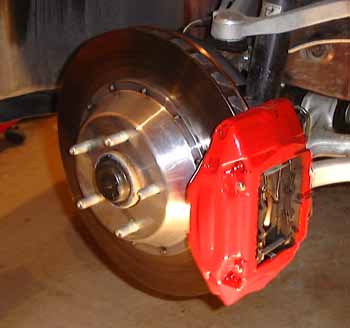

My front rotors look like this, for better or for worse...

I guess the picture above was closer than I though. Here's an actual picture of my rotors and calipers...
