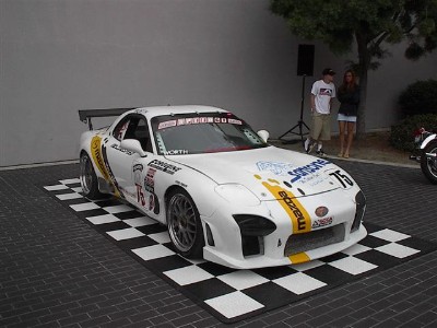

This is the look I'm trying to acheive, the rear 3/4 look of the Pettit race car, except minus the stickers, the wing, the GTC bumper, plexiglass windows, well... :
and with slight flares on the front, and my 99 bumper. I want the flares to be integrated with the stock sheet metal, like the red car above (which was molded). I really want stay with sheetmetal everywhere (more for my peace of mind, more then anything else I suppose), so I'm having the flares duplicated in sheetmetal.
Cesar's car (the red car) has actually had the FG molded flares for supposedly quite awhiles, so it looks like if done right, this method can last a reasonable whiles. I hear conflicting info as to whether or not he daily drives it (as opposed to being a trailer queen).
If I put skirts (other then the FEED sidesteps), I would have to have it fitted to the flared sheetmetal at the bottom, plus it would make me want to paint the 99 lip to match.
If the lip was not painted, the lower body line of the car (extended lower by the sideskirts) would not match the bumper lip. I've debated it for awhiles, and I think I really like the 99 lip unpainted, so leaving off any sideskirts (that extend the body line lower) would not cause a break in the body line from the bumper lip to the sideskirts. I need to dig up a pic of what I'm talking about.

I thought I would bring this thread back from the grave in order to comment upon the shapeliness of that female's legs up above .

HAHA!! funny you mention that... She appeared in almost all of my shots from SS5! ....I hope her boyfriend doesnt frequent the forum and hunt me down...
