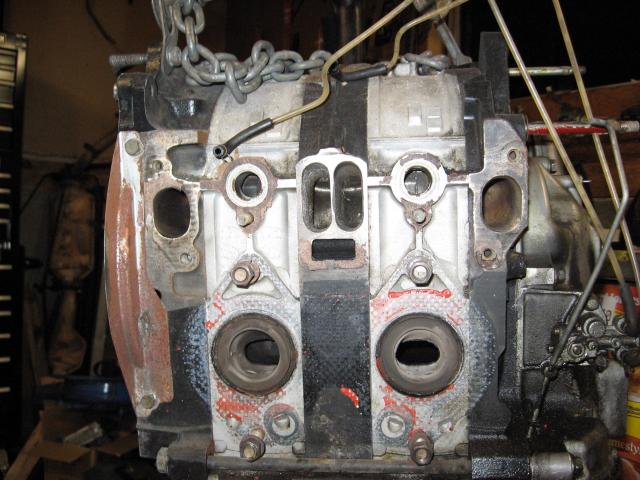

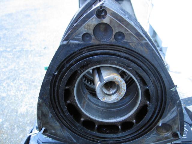

This is a Hayes rebuild. Streetported, with a stock Nikki. It ran a little lean it looks like. The PO said the oil line blew off when she was reving it for some friends (showing off) while it was cold. I believe it because there was oil everywhere. Up between the radiator and the radiator mount, fan shroud, every other nook and crannie in the front of the engine bay. What a mess.

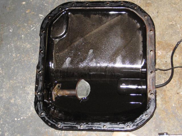

But that's not what killed the engine. When I pulled the oil pan off, the pickup tube was just sitting there. Swimming in the oil. You can clearly see all the metal bits. Freaking Hayes. Has that ever happened to any of your engines? It's never happened to any of mine.

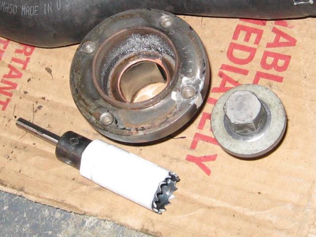

What's even more annoying about this engine was the 19mm bolt. I tried heat, impact gun, yelling at it, more heat. Nothing worked. So I grabbed the hole saw witht he broken bit and had at it. A few minutes and lots of shavings later, it finally unscrewed like a correctly torqued one. Freaking Hayes.
All the side plates, rotors, bearings, shaft, stationary gears were dead. Even the rotor housings had some funny wear from running without oil. Oops, I don't have a picture. I'll snap one or two later today.
All the soft seals were replaced and 6 side seals. Some of the corner seals were pretty shabby and replaced too. Fortunately the apex seals looks rather nice, and the springs still had some lift. I grabbed a set of decent side plates off the shelf and a friend brought over another rotating assembly and two rotor housings. One gasket set, front + rear seals and oil o-rings, and a little time and patience added up to a nice looking 12A.

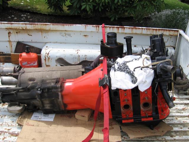

We threw it in the REPU and transported it down to the shop.
It's in its new home now and runs great. It's got over a hundred miles on it now. It's nice and smooth and fires right up. No smoke. Ah, no pic. I'll get one later.

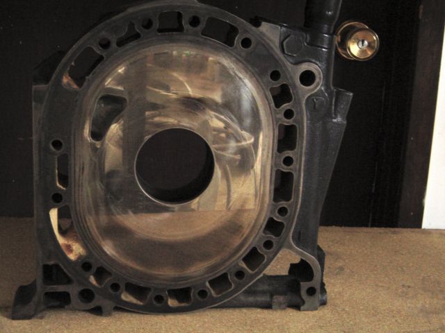

heres pics of a hayes core motor i got.

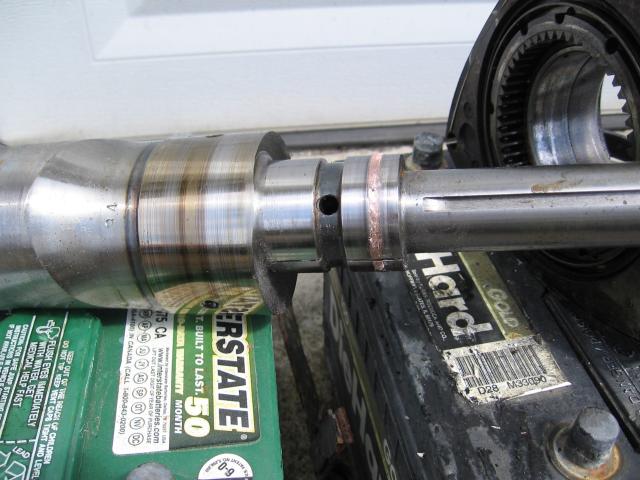

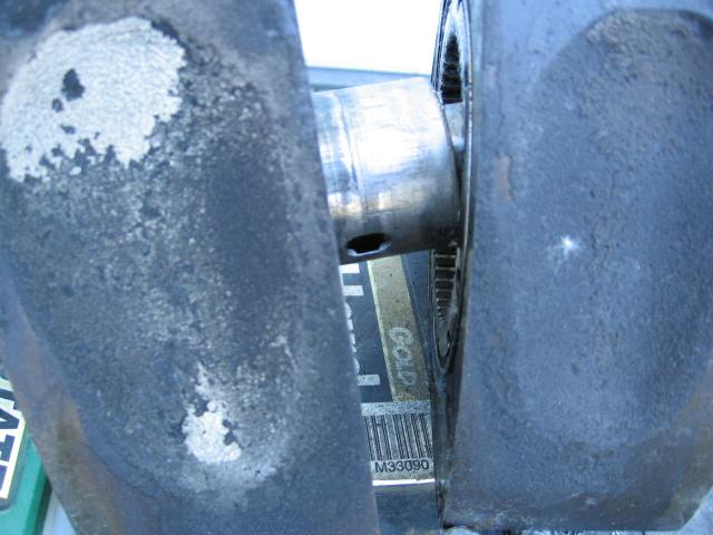

The mushroomed shaft, which I had to hit to to get the front plate off. The side seals are welded into the rotor.
Here's the only shot of the bearing still on the shaft.
And this is after I cut it with the dremel and chisseled it off.
Heh.

That happens when the oil pick up falls off and lays in the sump!

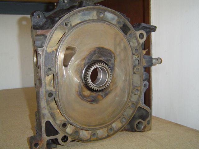

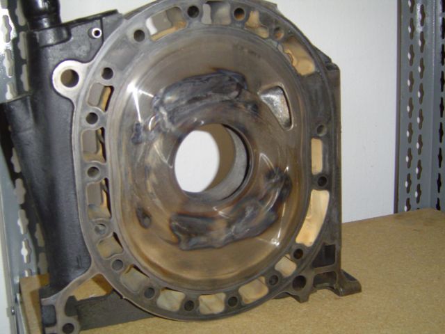

Here are some pictures I got of the side plates of that engine. Check out the lovely burn marks.
