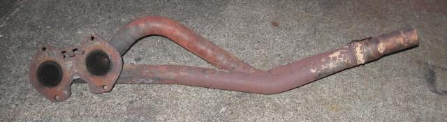

The header I acquired for the red truck.
I'll have to cut off the crappy pipe on the end. Not a problem.

I cut off the crappy pipe yesterday.
I got the white truck running again yesterday. It's a lot quieter inside than before. Now when it returns to idle, I can't tell what RPM it's at unless I look at the tach. Did it stall? heh.
The shifting is tons smoother now. The tranny isn't metal to metal anymore. It's actually easier to drive. The only drawback is the lack of high end power with the manifold. I suspect two reasons. For one thing, it's streetported, and they're affected more by exhaust flow than stock ports, and another thing is the exhaust itself is utter garbage. Thinwall 2" pipe, then into a reducer/enlarger that ups it to 2.5, which is then gap welded into a crappy 3 inch inlet/outlet three chambered "turbo" style muffler, then into a reducer back down to 2", then into a long glasspack (both muffler and glasspack sound hollow when you tap on them) and from the glasspack it goes 2 1/4 and extends over the rear end and all the way to the rear bumper, at which point it exits through a dual Monza tip thing.
It was noisey and obnoxious before with the header, and the crappy components certainly weren't helping flow, but now with the manifold, it's actually not as bad sounding. I mean it still sounds bad, but not as loudly.
The only drawback is the loss in high end power. Low end seems to have gained a little torque. It's quite driveable below 2k. It's good enough for now.
Would I want to drive it every day? Heck no. The exhaust simply needs to be redone with quality parts (probably RB header, presilencer, and a powerpulse muffler modded to fit the truck, like I did on my bro's RX-4 wagon. Also a couple thick wall U-bends and straight pipe). I guarantee power would be an order of magnitude higher than before and the noise would be further reduced than it is now. The best of both worlds, and all in 2".

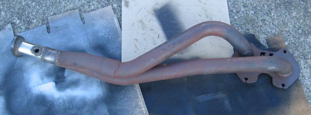

I made some progress on the header. It has a flange and an O2 bung.
And here's how it looks in the bay. I could've gone the 9 yards and ground off the rust but this header is almost done for as it is. Notice the patch job on the rear pipe? Can you see the exfoliating metal, especially on the front pipe? That gives it character. Too much rich running in its former life.
Wacky will appreciate this. It has a dual stud pattern for Hitachi or Nikki. It was already like that when I got it. The channels were added by me.
