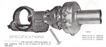

There was a version of the Turbonique Drag Axle , that was like a second pinion assembly bolted in place of the ring gear cover. (The one shown is on a Halibrand quick change diff centre section), with nothing less than a thermolene powered rocket nozzle mounted to the diff.
At the touch of a button, it would add an extra 1,300 horsepower.
Attached Thumbnails Has anyone powered a turbo by liquid rocket fuel instead of engine exhaust?-large967.jpg

Yes, I like that one!
Another they had for sale was an adapter for that rocket motor onto a VW transaxle as used in their "Black Widow" drag car that took flight running 9 sec 1/4 mile at 160mph.
The wreckage of that VW with a testimonial from the driver was one of their advertisements- lol.
